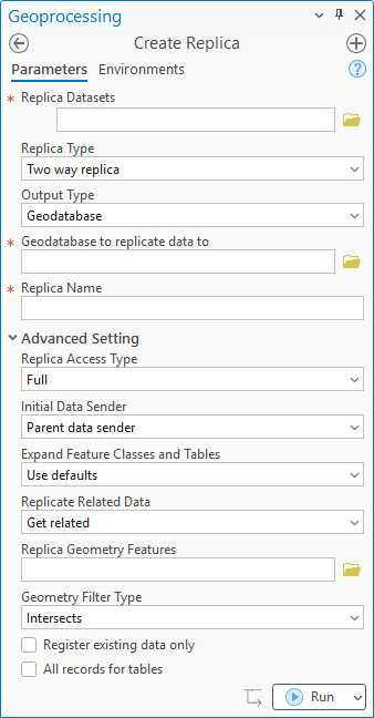

Create Replica tool parameters
How you set the parameter values when you run the Create Replica geoprocessing tool depends on the type of replication you need and what you need to replicate. To help you understand what values to use, the following describes the input parameters for the Create Replica geoprocessing tool.
Parameters
The following is an explanation of each parameter on the Create Replica geoprocessing tool:
  • Replica Datasets—To replicate a subset of data, apply definition queries and use the drop-down arrow to add them to the replica. For other datasets, browse to and select the datasets or use the drop-down arrow if the layers exist in your map.
  • Replica Type—Choose a checkout, one-way, one-way child-to-parent, or two-way replica.
  • Output Type—The output type for the data that will be replicated.
    • Geodatabase—Replicates the data to a geodatabase. This is the default.
    • Xml file—Replicates the data to an XML workspace document.
    • New file geodatabase—Replicates the data to a new file geodatabase that will be created when the tool is run and is only valid for one-way and checkout replicas.
  • Geodatabase to replicate data to—This parameter is required if Output Type is set to Geodatabase and replicates to a local or remote destination geodatabase. Remote geodatabases can be accessed using geodata services running on an ArcGIS Server site. Browse to and select the geodatabase or geodata service to receive the data. If your replica type is checkout or one way, the destination can be a file geodatabase; otherwise, an enterprise geodatabase is required.
    Using this parameter to replicate data to a geodatabase allows you to create a replica in a connected environment. See how to create a checkout replica, one-way replica, or two-way replica for detailed workflow steps.
    When using the Create Replica geoprocessing tool, the Output Type can be set to Geodatabase, XML, or New file geodatabase.
  • XML file to replicate data to—This parameter is required if Output Type is set to Xml file and outputs an XML workspace document as an XML file. The XML file option supports disconnected environments where you can send the XML workspace document to the destination and import it to complete replica creation. See how to create a replica in a disconnected environment for detailed workflow steps.
    When using the Create Replica geoprocessing tool, Output Type can now be set to either Geodatabase or Xml file, which works well in disconnected environments.
  • File geodatabase location—This parameter is required if Output Type is set to New file geodatabase. File geodatabase location is the location where a new file geodatabase will be created when the tool is run and will host the child replica. Using the New file geodatabase parameter for the Output Type is only valid for one-way and checkout replicas.
    • File geodatabase name—The name of the file geodatabase that will be created to host the child replica.
  • Replica Name—Enter the name for the replica to be created.

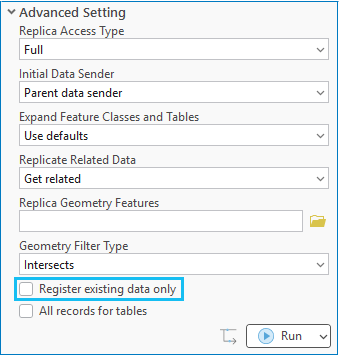

Register existing data only
Creating a replica is a process that involves copying data from the source geodatabase to a target geodatabase and registers a replica in each geodatabase to describe the data that has been replicated. The replica creation process of copying data to another geodatabase and registering it can be time-consuming on large datasets.
Use the Register existing data only check box when creating a replica if you need to replicate large datasets or when you have identical data in two different geodatabases. This creates the replica versions needed to synchronize changes between the geodatabases but does not go through the lengthy process of copying data because it already exists in both locations.
The Register existing data only check box can be found on the Create Replica geoprocessing tool under Advanced Setting.
Register existing data only check box on the Create Replica geoprocessing tool
  • Checked—If Register existing data only is checked, it is assumed that the data already exists in the child geodatabase and will be used to register the replica.
    Note:
    If the Register existing data only check box is checked, the All records for tables check box will not be available.
  • Unchecked—If Register existing data only is unchecked, which is the default, data in the parent geodatabase will be copied to the child geodatabase.
Note:
All of the following requirements must be met before using the Create Replica geoprocessing tool with the Register existing data only check box checked. The geodatabase replication requirements, along with the requirements of having matching dataset names and that datasets are owned by the user connected to the child geodatabase are the only verifications made during the replica creation process. Once the replica has been created, if other requirements weren't previously met, errors will be encountered during attempts to synchronize the replica.
Prior to using the Create Replica geoprocessing tool with the Register existing data only check box checked, datasets in the child (target) geodatabase must meet the following requirements:
  • Meet the geodatabase replication requirements including the additional replication requirements that apply based on the replication type selected.
  • For one-way, child-to-parent replicas, and two-way replicas, the data on the child replica must be registered as versioned.
  • Be owned by the user who is connected to the child geodatabase.
  • Have the same names as the datasets in the parent database.
  • Have the same schema, rules, relationships, and properties as the datasets in the parent database
  • Have the same geometry types as the datasets in the parent database.
Tips
Keep the following in mind when checking the Register existing data only check box:
  • If Global IDs are a requirement for the replication type, you must make sure to add Global IDs to the data before you copy it to the other geodatabase. If you use functionality within ArcGIS to copy the data, make sure to use either copy and paste, or XML workspace export and import.
  • You must be connected as the owner of the data on the target geodatabase when creating the replica.
  • Whatever filters are applied during the replica creation process also are applied to the data in the relative geodatabase.
Limitations
It's important to be aware of the following limitations when using the Register existing data only option:
  • If the Register existing data only check box is checked within the Create Replica geoprocessing tool, there is no option to select the matching dataset in the child geodatabase, therefore prior to checking this check box, you must manually ensure that the datasets in the child geodatabase have been configured properly and meet all the geodatabase replication requirements.
  • When using the Register existing data only check box, it is assumed that the data is identical in both geodatabases, so any differences that exist between the datasets in the parent and child replica at the time when the replica is created, will not be synchronized. If there are any layers missing in the target geodatabase, the Create Replica geoprocessing tool will fail and will return an error message.
