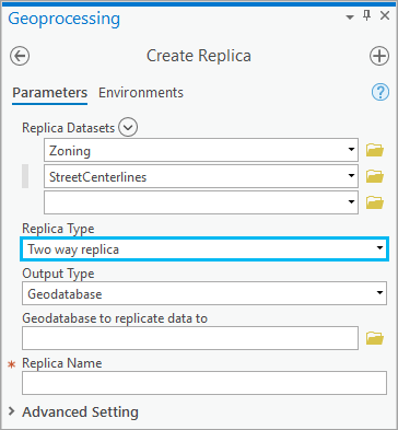

  5. Ensure Two way replica is selected from the Replica Type drop-down menu.
    Replica Type
    Two way replica is the default setting.

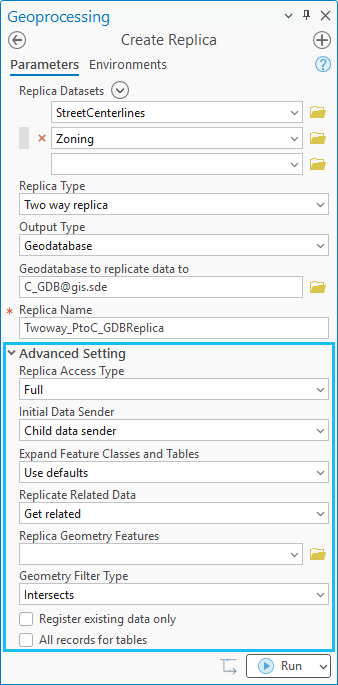

  8. Click Advanced Setting to expand additional options if you want to override the replication default options. If you are not changing the default options, skip to step 15.
    Advanced Setting in the Create Replica tool.
  9. Under Advanced Setting, for Replica Access Type, choose Full or Simple for the geodatabase model.
    Learn more about the replica access type options
  10. Use Initial Data Sender to specify which replica can send changes when in disconnected mode.
    This ensures that the relative replica doesn't send updates until the changes are first received from the initial data sender. If you are working in a connected mode, this parameter is not used.
    • Child data sender—The child replica is the initial data sender. This is the default.
    • Parent data sender—The parent replica is the initial data sender.
  11. Select one of the following options from the Expand Feature Classes and Tables drop-down menu:
    • Use defaults—The replica will include the tables that are part of any extended dataset type—such as a topology, relationship class, or network—in which the feature classes or tables in the replica participate. The default for feature classes is to replicate all features intersecting the spatial filter. If no spatial filter has been provided, all features are included. The default for tables is to replicate the schema only.
    • Add with schema only—Adds the schemas of the feature classes and tables in the extended datasets but not the data for them.
    • All rows—Adds all rows for the feature classes and tables in the extended datasets.
    • Do not add—Adds the datasets that you defined in step 4, but does not add the feature classes and tables from the extended dataset types in which the datasets participate.
  12. For Replicate Related Data, choose Get related or Do not get related to specify whether to replicate rows related to rows already in the replica.
    Get related is the default setting.
    See Replication and related data to learn more about how this setting works.
  13. Use one of the following options to define which features will be included in the replica:
    • Choose a feature layer from the Replica Geometry Features drop-down menu.
      The replica geometry features can be a feature layer that contains one or more points, lines, or polygons.
      If there is one feature in the feature layer, the features in the replica datasets that intersect that feature will be replicated. If there are two or more features in the feature layer, the geometries are merged, and only data that intersects the merged geometries will be replicated.
      If filters (such as a definition query) have been defined on the replica geometry features, only features that satisfy these filters will be used to define the replica geometry.
    • Use the Extent environment setting to define which features will be included in the replica.
    If both Replica Geometry Features and the Extent environment are set, the Replica Geometry Features setting is used.
    If neither Replica Geometry Features nor the Extent environment is specified, the full extent of the data is used.
  14. Optionally, from the Geometry Filter Type drop-down menu, choose the option that specifies the spatial relationship between the Replica Datasets and Replica Geometry Features parameter values and how that relationship will be filtered.
    The tool applies the spatial relationship to data in the extent defined by the Replica Geometry Features parameter to limit the data included in the replica.
    • Intersects—Features in the Replica Datasets parameter value that intersect features in the Replica Geometry Features parameter value will be extracted to the Check out replica. This is the default.
    • Contains—Features in the Replica Datasets parameter value that are contained by the selected feature in the Replica Geometry Features parameter value will be extracted to the Check out replica.
