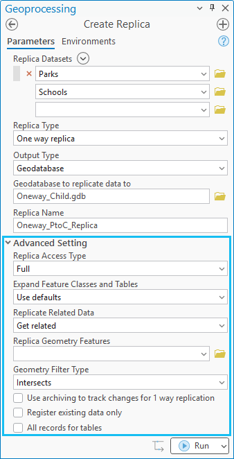

    The Create Replica geoprocessing tool dialog box appears with default settings.

  8. Click Advanced Setting to expand additional options if you want to override the default replication options. If you are not changing the default options, skip to step 15.
    Advanced Setting in the Create Replica tool
  9. Under Advanced Setting, for Replica Access Type, choose Full or Simple for the geodatabase model.
    Learn more about the replica access type options
  10. From Expand Feature Classes and Tables, select one of the following four options:
    • Use defaults—The replica will include the tables that are part of any extended dataset type—such as a topology, relationship class, or network—in which the feature classes or tables in the replica participate. The default for feature classes is to replicate all features intersecting the spatial filter. If no spatial filter has been provided, all features are included. The default for tables is to replicate the schema only.
    • Add with schema only—Adds the schemas of the feature classes and tables in the extended datasets but not the data for them.
    • All rows—Adds all rows for the feature classes and tables in the extended datasets.
    • Do not add—Adds the datasets that you defined in step 4, but does not add the feature classes and tables from the extended dataset types in which the datasets participate.
  11. For the Replicate Related Data setting, choose Get related or Do not get related to specify whether to replicate rows related to rows already in the replica.
    Get related is the default.
    Note:
    See Replication and related data to learn more about how this setting works when replicating data.
  12. Use one of the following options to define which features will be included in the replica:
    • Choose a feature layer from the Replica Geometry Features drop-down menu.
      The replica geometry features can be a feature layer that contains one or more points, lines, or polygons.
      If there is one feature in the feature layer, the features in the replica datasets that intersect that feature will be replicated. If there are two or more features in the feature layer, the geometries are merged, and only data that intersects the merged geometries will be replicated.
      If filters (such as a definition query) have been defined on the replica geometry features, only features that satisfy these filters will be used to define the replica geometry.
    • Use the Extent environment setting to define which features will be included in the replica.
    If both Replica Geometry Features and the Extent environment are set, the Replica Geometry Features setting is used.
    If neither Replica Geometry Features nor the Extent environment is specified, the full extent of the data is used.
  13. Optionally, from the Geometry Filter Type drop-down menu, choose the option that specifies the spatial relationship between the Replica Datasets parameter values and Replica Geometry Features parameter values and how that relationship will be filtered.
    The tool applies the spatial relationship to data in the extent defined by the Replica Geometry Features parameter to limit the data included in the replica.
    • Intersects—Features in the Replica Datasets parameter value that intersect features in the Replica Geometry Features parameter value will be extracted to the Check out replica. This is the default.
    • Contains—Features in the Replica Datasets parameter value that are contained by the selected feature in the Replica Geometry Features parameter value will be extracted to the Check out replica.
  14. Optionally, check Use archiving to track changes for 1 way replication at the bottom of the tools dialog box to turn this option on.
    To use archiving for one-way replicas, the parent workspace must be connected to the default version. For one-way child-to-parent replicas, the child workspace must be connected to the default version.
  15. Optionally, check Register existing data only if the data already exists in the child geodatabase and is used to define the replica datasets.
    • If Register existing data only is unchecked, which is the default, data in the parent geodatabase is copied to the child geodatabase.
    • If Register existing data only is checked, the All records for tables option will not be available.
    See Register existing data only for a list of additional geodatabase replication requirements that must be met prior to selecting this option on the Create Replica geoprocessing tool.
  16. Optionally, use the All records for tables option to specify whether all records or only the schema will be copied to the child geodatabase for tables that do not have filters applied (such as selections or definition queries).
    • Checked—For tables with no applied filters, all records will be copied to the child geodatabase for tables. This option will override the Expand Feature Classes and Tables parameter value.
    • Unchecked—For tables with no applied filters, only the schema will be copied to the child geodatabase for tables. Tables with applied filters will be honored. This is the default.
    Note:
    The All records for tables option will not be available if the Register existing data only option is checked.
  17. Click Run to create the replica.
