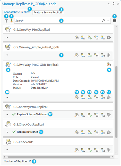

Geodatabase Replicas tab reference
Manage geodatabase replicas from the Geodatabase Replicas tab of the Manage Replicas pane.
The Geodatabase Replicas tab provides a comprehensive interface for managing geodatabase replicas. Each geodatabase replica is displayed as a card with options for managing the replica.
The following image shows the tools and options available to manage geodatabase replicas from the Geodatabase Replicas tab. Each tool is explained in the table below.
Elements of the Geodatabase Replicas tab
The following table correlates the numbers in the image above with its corresponding element number and tool description.
Element
Description
Geodatabase Replicas tab—Displays all replicas in a geodatabase explicitly created from the Create Replica or Create Replica from Server geoprocessing tools.
Feature Service Replicas tab—Displays all replicas in a geodatabase created from feature services offline workflows.
Filter Filter—Use this filter to control which replica types are displayed in the Manage Replicas pane. Filter options include: All Types, Checkout, One-way, and Two-way.
Sort Sort by creation—Sort the order in which replicas are displayed in the Manage Replicas pane. You can sort replicas by date, name, owner, role, and version.
5
Search box Search—Search for replicas using a text string. Searches can be based on replica names or any of the other fields listed in the Sort option, such as date, owner, role, and version.
6
Manage Replicas Menu Menu—Access multiple commands for managing replicas from this menu. You can select from the following: Refresh Replicas, Expand/Collapse All cards, Create Replica, Create Replica from Server, Synchronize changes, Export Data Changes Message, Export Acknowledgment Message, Import Message, Reexport Unacknowledged Messages, and Logging Properties.
See the Geodatabase Replicas menu options section below for details.
7
Replica cards—Replicas are displayed as cards in their collapsed state by default. An expanded view of the card shows more details about the replica. See the Geodatabase Replicas menu options section below for details.
8
Replica Type—Icons located to the left of the replica name indicate the replica type as a two-way replica , one-way replica , or checkout /check-in replica . See Replication types for more details.
9
Replica in conflict Replica Conflicts—When synchronizing changes between a replica pair, if the conflict resolution policy on a two-way or one-way replica is set to manually resolve conflicts, your replica pair may synchronize successfully, however, conflicts may exist. When conflicts exist within a replica, this Replica in conflict icon displays on the replica card. See Resolve synchronization conflicts manually for workflow details to review and resolve conflicts manually.
10
Expand / Collapse Replica cards Drop-down arrow—An expanded view of a card shows you all the general information for the replica.
11
Synchronize Changes Synchronize Replica Changes—Synchronize changes between a replica pair directly from a replica card by clicking the Synchronize Changes button at the bottom left of the card. The advantage of this approach is that it launches and automatically populates the Synchronize Changes geoprocessing tool with all the relevant information for your replica. You can then review the default settings on the tool and change the values as needed.
12
Export Data Changes Message Export Data Changes Message—Export all new data changes (any inserts, updates, and deletes applied to the replica version since the last data change message was exported) and all unacknowledged data changes (previously exported changes for which you have not received an acknowledgment) to an output delta file stored as either an XML file or a file geodatabase.
13
Export Acknowledgment Message Export Acknowledgement Message—Exporting an acknowledgment message is completed by the data receiver after receiving one or more data change messages to acknowledge all data change messages. If no acknowledgment messages are sent, the data sender resends the changes and maintains the information needed to resend those changes until they are acknowledged. As a result, the data sender's geodatabase can become large and new data change messages can become large as well.
14
Import Message Import Message—Import Message can import either data change messages or acknowledgment messages. Importing a data change applies data changes from the relative replica and also updates the replica's metadata. Importing an acknowledgment updates a replica's metadata such that it knows what changes to include in the next export.
15
Re-Export Unacknowledged Messages Re-Export Unacknowledged Message—Re-Export Unacknowledged Messages allows you to reexport data changes that may have been lost in transit or need to be sent again and only includes edits that were sent in the original data change message.
16
Replica Options Cog—The commands accessible from the Replica Options button are applied on an individual replica. Alternatively, you can right-click the replica card to access these same commands.
See the Geodatabase Replicas options section below for more details.
17
Analyze Replica Schema Validated—Communicates the completed status of running the Validate schema command accessible from the Replica Options button .
18
Analyze Replica Refreshed—Communicates the completed status of running the Refresh command accessible from the Replica Options button .
19
Number of Replicas—Provides a count of the total number of replicas that appear within the Manage Replicas pane. In addition, this count honors searches and any filter that was applied to the replica types in the Manage Replicas pane.

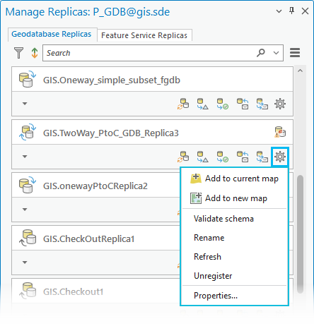

The following commands are accessible from the Options button on geodatabase replica cards on the Geodatabase Replicas tab. The options apply to the replica from which you access the options:
The options available for geodatabase replicas using the Options button
  • Add to current map—This option immediately adds all the datasets that are a part of this replica to the current map. This option is not available if the active view is not a map.
  • Add to new map—This option creates a map and immediately adds all the datasets that are a part of this replica to the new map.
    Note:
    When you add replica datasets to a map using either of these options, the connected geodatabase user must have privileges granted to view the data. Otherwise, an error is returned for any replica dataset not added due to insufficient privileges of the connected user.
    If any of the feature classes or tables in the replica dataset also participate in a relationship class, the connected geodatabase user must also have the privilege to view all the origin and destination classes that participate in the relationship class for the replica datasets to be added to the map. Otherwise, none of the datasets that participate in the relationship class are added to the map, and an error is returned for any replica datasets not added due to insufficient privileges of the connected user.
    See Grant and revoke dataset privileges in databases and enterprise geodatabases to learn more about geodatabase privilege requirements.
    See the Description tab on the Replica Properties dialog box to learn more about the list of datasets included in the replica.
  • Validate schema—Validates the replica schema. This automatically removes invalid datasets. Datasets can become invalid if they have been renamed, deleted, or unversioned.
  • Rename—Renames the replica.
    Note:
    You must be the owner of the replica or connected as the geodatabase administrator to rename the replica.
  • Refresh—Refreshes the replica. The latest state of the replica's properties are retrieved or updated.
  • Unregister—Unregisters the replica.
    Note:
    Alternatively, you can run the Unregister Replica geoprocessing tool to unregister any type of replica from an enterprise geodatabase.
  • Properties—Opens the Replica Properties dialog box, which is described below.

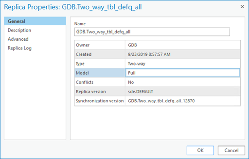

General tab
Under the General tab, the following replica properties are displayed:
The General tab on the Replica Properties dialog box
  • Name—The name of the replica qualified with the name of the database user who owns the replica.
  • Owner—The user who created the replica.
  • Created—The date and time the replica was created.
  • Type—The type of replica: Checkout/Check in, One-way, or Two-way.
  • Model—The replica access type that was assigned when the replica was created.
  • Conflicts—Indicates whether the replica contains unresolved conflicts as a result of synchronization.
  • Replica version—The replica version associated with this replica.
  • Synchronization version—The synchronization version associated with this replica.

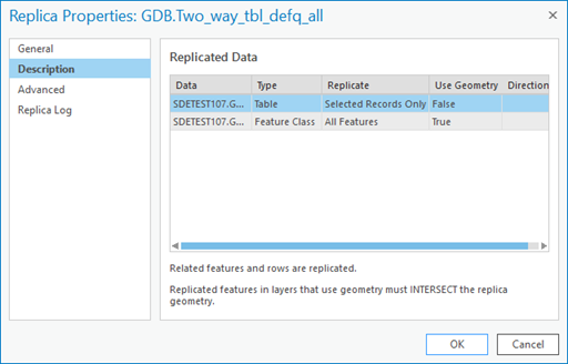

Description tab
The Description tab on the Replica Properties dialog box lists the datasets that are included in the replica and provides two options for managing the datasets in the replica.
The Description tab of the Replica Properties dialog box
The values present for the datasets reflect the properties selected during the replica creation process. These dataset properties include the following:
  • Data—The source of the replicated data.
  • Type—The type of data replicated. Possible types are table, feature class, or relationship class.
  • Replicate—Indicates what filters, if any, were set when the replica was created. Filters include All Features, Schema Only, Selected Records Only, query definitions, or selections sets.
  • Use Geometry—This is set to True if you use the spatial extent or you specify an extent upon replica creation.
  • Direction—This property is valid for replicated relationship classes only. This displays Forward, Backward, or None, depending on the option chosen during replica creation.
Note:
Replicas created in ArcGIS Pro only show a direction of forward. Replicas created in ArcMap can show directions other than forward.
The first sentence located on the bottom of this dialog box indicates whether related features and rows are replicated. This information is based on the Replicate Related Data value, which is located under Advanced Setting on the Create Replica geoprocessing tool.
A description of the spatial relationship used to determine how the replica geometry was applied is contained within a second sentence at the bottom of this dialog box and is related to the Use Geometry column. Replicas created in ArcGIS Pro always use an INTERSECT spatial relationship, as this is the default behavior for the Create Replica geoprocessing tool. Other spatial relationships, such as MUST BE COMPLETELY INSIDE, can exist for replicas created outside of ArcGIS Pro.
The Use Geometry column always displays True for feature classes belonging to replicas created from ArcGIS Pro. See Replica Geometry Features to learn more about available options to define the replica geometry.
If the Use Geometry column displays False, the replica was created outside of ArcGIS Pro and the full extent of the dataset was used to determine what is replicated for that particular dataset.

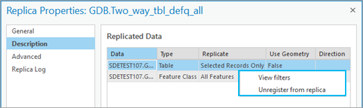

Right-click one of the datasets in the Replicated Data list to open the following dataset options:
On the Replica Properties dialog box, on the Description tab, select View filters or Unregister from replica.
  • View filters—If filters, such as a selection set or a definition query, were applied to the data when the replica was created, this option becomes active and can be used to display these replica dataset filters.
  • Unregister from replica—To remove a dataset from the replica, right-click the dataset and click this option. The replica no longer references the dataset; however, it still remains in the geodatabase. To remove a topology, you must remove all the classes at once.
    See Replica schema changes for important information about removing datasets from a replica.

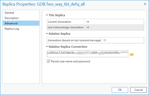

Advanced tab
The Advanced tab on the Replica Properties dialog box contains information about the generation numbers associated with the replica. A generation number is a number maintained by the geodatabase that keeps track of messages being sent and received by the replica.
For example, the first data message sent from one replica to its relative replica makes the current generation of the replica equal 1. When the relative replica receives that message, its relative replica generation is set to 1 as well. When the initial replica receives an acknowledgment of the data message, its last acknowledged generation is set to 1.
The Advanced tab displays the following information about generation numbers:
  • This Replica
    • Current Generation—The current generation number, which describes how many data messages were sent from the replica.
    • Last Acknowledge Generation—The generation number of the most recent data message for which an acknowledgment has been received.
  • Relative Replica
    • Generation (based on last received message)—The current generation number of the relative replica based on the last message imported into this replica.
  • Relative Replica Connection
    This contains the connection information of the relative replica. You can set this information by browsing to the location of the relative replica geodatabase's connection file (.sde). After doing so, the Persist user name and password check box becomes available. If you check this box, the username and password are saved; otherwise, they are not. By default, they are not persisted for security reasons.
    Connection information is used when you run the Synchronize changes command or the Synchronize Changes geoprocessing tool to automatically fill in the relative replica information. This prevents you from having to browse to the connection file when you synchronize changes. If the username and password are not persisted, you are prompted to provide them.
