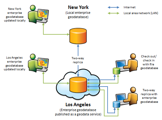

Diagram depicting how geodata services allow you to check out and check in data and perform replication over the internet or intranet.
In the diagram above, a company may want to set up enterprise geodatabases to manage data between its Los Angeles and New York offices. The replica was first created by publishing the Los Angeles geodatabase as a geodata service with the Replication operation allowed. An administrator in New York then accessed this geodata service over the internet and used the Create Replica From Server tool to create a replica. Once this replica was created, editors perform updates to each enterprise geodatabase locally. The administrator in New York periodically runs a geoprocessing model to connect to the geodata service in Los Angeles and synchronize changes in both directions over the internet. This keeps the geodatabases synchronized, allowing users to access the same information at either location.

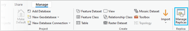

    • From the Catalog view, follow these steps to access the Manage Replicas pane using the Manage Replicas button on the Manage contextual tab.

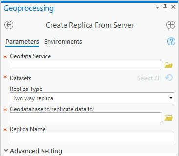

    The Create Replica From Server geoprocessing tool dialog box appears with default settings.

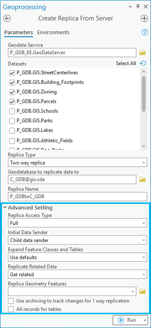

  10. Click Advanced Setting to expand additional options if you want to override the default replication options. If you are not changing the default options, skip to step 15.
    Advanced Setting fields on the Create Replica From Server geoprocessing tool dialog box
  11. Under Advanced Setting, for Replica Access Type, choose Full or Simple for the geodatabase model.
    Learn more about the replica access type options
  12. Optionally, for Initial Data Sender, specify which replica can send changes when in disconnected mode.
    • Child data sender—The child replica is the initial data sender. This is the default.
    • Parent data sender—The parent replica is the initial data sender.
  13. Optionally, from Expand Feature Classes and Tables, select one of the following four options:
    • Use defaults—The replica will include the tables that are part of any extended dataset type—such as a topology, relationship class, or network—in which the feature classes or tables in the replica participate. The default for feature classes is to replicate all features intersecting the spatial filter. If no spatial filter has been provided, all features are included. The default for tables is to replicate the schema only.
    • Add with schema only—Adds the schemas of the feature classes and tables in the extended datasets but not the data for them.
    • All rows—Adds all rows for the feature classes and tables in the extended datasets.
    • Do not add—Adds the datasets you chose in step 6, but does not add the feature classes and tables from the extended dataset types in which the datasets participate.

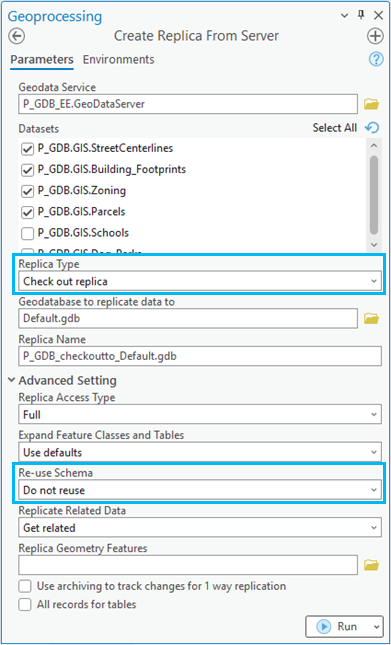

  14. Optionally, for Re-use Schema, choose from one of the two available options, Reuse or Do not reuse, which is the default setting.
    The Reuse schema option creates a replica using a template, allowing you to reuse a geodatabase that contains the schema of the data you want to replicate. This reduces the amount of time required to replicate the data.
    The Reuse schema option is intended for an empty schema on the child. You must delete the data from the child replica prior to using the reuse schema option.
    Note:
    This option is available for checkout replicas only and can only be performed when replicating to a file geodatabase.
    Create a check out replica with the Re-use Schema option on the Create Replica From Server tool
