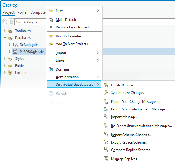

  2. In the Catalog pane, right-click an existing geodatabase connection and click the Distributed Geodatabase context menu.
    Note:
    To create a replica, you must connect to the enterprise geodatabase as a user with privileges to create data in the database.
  3. Select Create Replica .
    Distributed Geodatabase context menu options

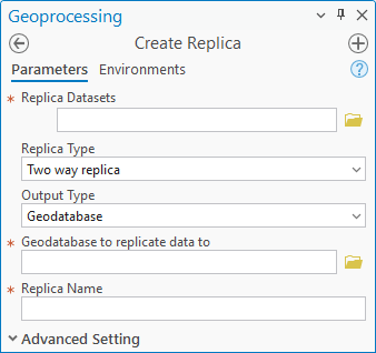

    The Create Replica geoprocessing tool dialog box appears with default settings.
    Learn more about the Create Replica tool parameters

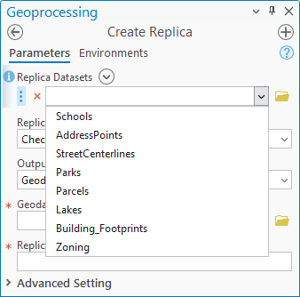

  4. For the Replica Datasets parameter, use the browse button to select the layers to replicate.
    Replica Datasets drop-down menu

    • There must be at least one layer in the map for the Add Many button to appear.
    • Use Add Many next to Replica Datasets to add multiple datasets at once.
    • If you are replicating a subset of data, apply definition queries as described in Determine datasets to replicate. Then use the drop-down menu to add datasets containing a subset of data to this replica. If the browse button is used to select datasets containing a subset of data instead of the drop-down menu, the definition queries will not be honored, and the default behavior will be applied.

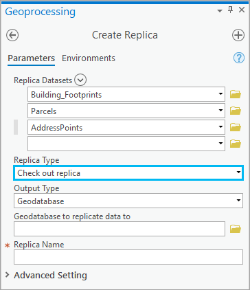

  5. For Replica Type, select Check out replica.
    Replica Type

  7. For Replica Name, type a name to identify the replica.
    The name of each replica must be unique to the user creating the replica.

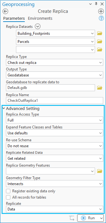

  8. Click Advanced Setting to expand additional options if you want to override the replication default options. If you are not changing the default options, skip to step 15.
    Advanced Setting in the Create Replica tool
  9. Under Advanced Setting, for Replica Access Type, choose Full or Simple for the geodatabase model.
    Learn more about the replica access type options

  11. Optionally, for Re-use Schema, choose from one of the two available options, Reuse or Do not reuse, which is the default setting.
    The Reuse schema option creates a replica using a template, allowing you to reuse a geodatabase that contains the schema of the data you want to replicate. This reduces the amount of time required to replicate the data.
    The Reuse schema option is intended for an empty schema on the child. You should delete the data from the child replica prior to using the reuse schema option.

  12. For Replicate Related Data, choose Get related or Do not get related to specify whether to replicate rows related to rows already in the replica.
    Get related is the default setting.

  13. Use one of the following options to define which features will be included in the replica:
    • Choose a feature layer from the Replica Geometry Features drop-down menu.
      The replica geometry features can be a feature layer that contains one or more points, lines, or polygons.
      If there is one feature in the feature layer, the features in the replica datasets that intersect that feature will be replicated. If there are two or more features in the feature layer, the geometries are merged, and only data that intersects the merged geometries will be replicated.
      If filters (such as a definition query) have been defined on the replica geometry features, only features that satisfy these filters will be used to define the replica geometry.
    • Use the Extent environment setting to define which features will be included in the replica.
    If both Replica Geometry Features and the Extent environment are set, the Replica Geometry Features setting is used.
    If neither Replica Geometry Features nor the Extent environment is specified, the full extent of the data is used.
  14. Optionally, from the Geometry Filter Type drop-down menu, choose the option that specifies the spatial relationship between the Replica Datasets parameter values and Replica Geometry Features parameter values and how that relationship will be filtered.
    The tool applies the spatial relationship to data in the extent defined by the Replica Geometry Features parameter to limit the data included in the replica.
    • Intersects—Features in the Replica Datasets parameter value that intersect features in the Replica Geometry Features parameter value will be extracted to the check out replica. This is the default.
    • Contains—Features in the Replica Datasets parameter value that are contained by the selected feature in the Replica Geometry Features parameter value will be extracted to the check out replica.
  15. Optionally, check Register existing data only if the data already exists in the child geodatabase and is used to define the replica datasets.
    • If Register existing data only is unchecked, which is the default, data in the parent geodatabase is copied to the child geodatabase.
    • If Register existing data only is checked, the All records for tables option will not be available.
    See Register existing data only for a list of additional geodatabase replication requirements that must be met prior to selecting this option on the Create Replica geoprocessing tool.
  16. Optionally, the use All records for tables option to specify whether all records or only the schema will be copied to the child geodatabase for tables that do not have filters applied (such as selections or definition queries).
    • Checked—For tables with no applied filters, all records will be copied to the child geodatabase for tables. This option will override the Expand Feature Classes and Tables parameter value.
    • Unchecked—For tables with no applied filters, only the schema will be copied to the child geodatabase for tables. Tables with applied filters will be honored. This is the default.
    Note:
    The All records for tables option will not be available if the Register existing data only option is checked.
  17. Optionally, use the Replicate parameter to specify whether the datasets in the Replica Datasets list will be included in the replica with all data and features, or only their schemas will be included.
    • Data—The features from the Replica Datasets parameter value will be included in the output replica. This is the default.
    • Schema Only—Only the schema for the Replica Datasets parameter value will be added to the output replica.
    Note:
    The Replicate option is only available when the Replica Type parameter is set to Check out replica.
  18. Click Run to create the replica.
