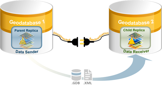

Geodatabase 1 contains the parent replica, the data sender. Geodatabase 2 contains the child replica, the data receiver.

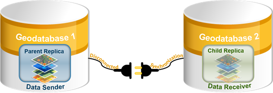

  1. Edits are completed.
    Edits are completed and saved in the geodatabase (Geodatabase 1).
    Edits are completed in the parent replica (data sender) in step 1 of the disconnected synchronization workflow.
  2. Export data changes from the data sender.
    In this workflow example, an orange triangle, also referred to as a delta, is used to represent the data changes or differences.
    Data changes are exported from the parent replica (data sender) in step 2 of the disconnected synchronization workflow.

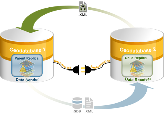

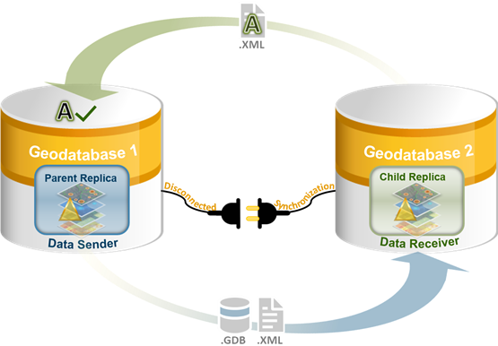

  4. Export an acknowledgement message.
    Once the data receiver imports the data change message, the data receiver uses the Export Acknowledgment Message geoprocessing tool to send an acknowledgment message back to the data sender (Geodatabase 1).
    Data receiver sends acknowledgment message in step 4 of the disconnected synchronization workflow.

  5. Import the acknowledgement message.
    The data sender uses the Import Message geoprocessing tool to import the acknowledgment XML message and updates the data sender replica's metadata (Geodatabase 1) so that it knows what changes to include in the next export.
    Data sender imports acknowledgment message in step 5 of the disconnected synchronization workflow.

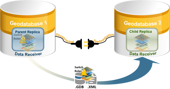

The following steps and diagrams show the parent replica sending a data change message with instructions to switch the role of the relative replica to that of the data sender.
  1. Ensure you are connected to a two-way replica.
    Step 1 to change the roles of the replica
  2. To switch roles, as the data sender, use the Export Data Change Message geoprocessing tool to export a data change message with the switch to receiver once the message has been exported option checked.
    When the parent replica exports the data change message containing these instructions to switch roles, it then becomes the data receiver.
    Step 2 to change the roles of the replica

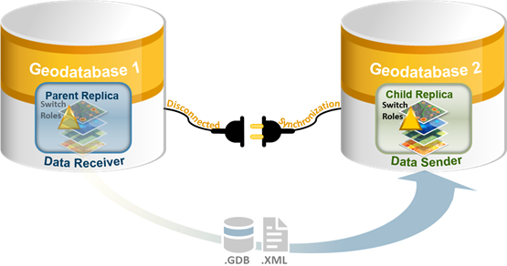

  3. As the data receiver, use the Import Message geoprocessing tool to import the data change message file containing the instructions to switch roles.
    Once the import has completed, it becomes the data sender.
    Step 3 to change the roles of the replica

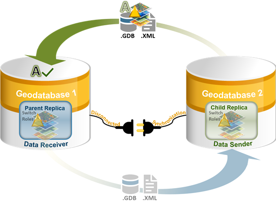

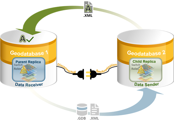

Acknowledge changes after switching roles
After switching roles in a two-way replica, there are two options available for the new data sender to acknowledge the message that switched the roles.
  • The new data sender can export an acknowledgement message—In the following diagram, the parent replica sent a data change message that switched roles. When the child replica received the message, it became a data sender, but since it had just switched roles, the system still allows it to send an acknowledgment message using the Export Acknowledgment Message geoprocessing tool.
    Use the Export Acknowledgement Message geoprocessing tool to acknowledge changes after switching roles.
  • The new data sender can send a data change message—In the following diagram, the parent replica sent a data change message that switched roles. When the child replica received the message, it became a data sender. Using the Export Data Change Message geoprocessing tool, the child replica can now send a data change message, which implicitly acknowledges the previous data change message from the parent replica. If you don't plan on sending a data change message in the near future, you should send an acknowledgment message.
    Use the Export Data Change Message geoprocessing tool to acknowledge changes after switching roles.

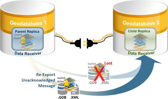

Reexport an unacknowledged data change message
The system allows replicas to resend unacknowledged data changes. You may want to do this when, as a data sender, the data change message either was not imported by the data receiver, was lost in transit, or needs to be resent. Another option is to wait until the next time you send data changes, since by default, this includes both new changes and any unacknowledged changes.
The following diagram shows a case where you need to reexport an unacknowledged data change message. Here, the parent replica sends a data change message and switches from sender to receiver. The message, however, gets lost, leaving both the parent replica and the child replica as data receivers. To solve this issue, the data receiver that has just switched roles uses the Re-export Unacknowledged Messages geoprocessing tool. In this case, it allows the parent replica to resend the unacknowledged data change message along with the switch roles to the child replica.
If changes have not been acknowledged or have been lost, the data sender can resend the data change message using the
