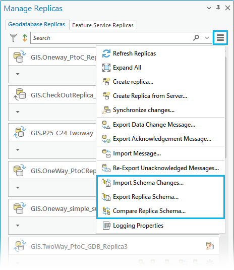

  • In the Manage Replicas pane, you can use the Manage Replicas Menu .
    Schema changes tools accessible from the Manage Replicas Menu

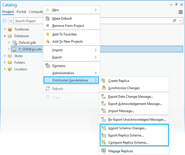

  • In the Catalog pane, you can right-click a geodatabase and access the Distributed Geodatabase context menu.
    Schema changes tools accessible from the Distributed Geodatabase context menu
