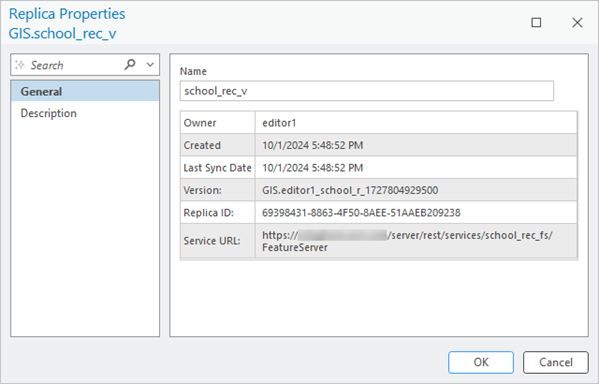

This same information is also present on the General tab of the Replica Properties dialog box.
When accessed from the Replica Properties dialog box, you can copy the information, which allows you to copy the feature service URL to paste into a browser to determine whether the service is still available, and allows you to copy the version name to look it up in the Versions view.
Use one of the following methods to open the feature service replica properties:
  • Click the Replica Options button on the feature service replica card and click Properties.
    See the Feature Service Replicas tab reference section below for a description of the Replica Options button.
  • Right-click the feature service replica card and click Properties.
The image below shows the general properties of a feature service replica named school_rec_v.
The General tab on the feature service Replica Properties dialog box

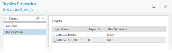

Identify the feature classes and tables in a feature service replica
Follow these steps to determine what feature classes and tables participate in a feature service replica:
  1. Open the Manage Replicas pane and click the Feature Service Replicas tab.
  2. Use one of the following options to open the properties of a feature service replica:
    • Click the Replica Options button on the replica card and click Properties.
    • Right-click the replica card on the Feature Service Replicas tab and click Properties.
    The Replica Properties dialog box appears.
  3. Click the Description tab.
    In the example below, there are two feature classes—schools and parks—in the school_rec_v feature service replica. The layer ID listed for each feature class is the unique identifier of the corresponding layer in the sync-enabled feature service. The value for the Use Geometry property (TRUE) indicates the spatial extent of the feature class was defined when the replica was created.
    The Description tab on the Replica Properties dialog box
    If the feature service replica was created by taking the feature service offline in ArcGIS Pro, the Use Geometry value is always set to TRUE. If the feature service replica was created when the feature service was taken offline using another application and the full extent of the feature class was used to determine what data to replicate, the Use Geometry value will be set to FALSE. See Replica Geometry Features to learn more about options to define the replica geometry.

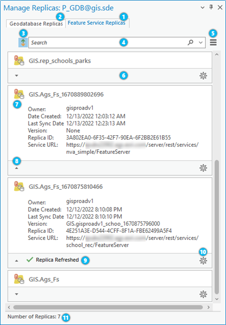

The Feature Service Replicas tab in the Manage Replicas pane displays all replicas in a geodatabase created from feature services.
From the Feature Service Replicas tab, you can unregister feature service replicas that are orphaned or no longer needed. Feature service replicas can become orphaned when the feature service is deleted, or the server no longer exists.
The following image shows the tools and options to manage feature service replicas from the Feature Service Replicas tab.
Elements of the Feature Service Replicas tab
The following table correlates the numbers in the image above with the corresponding element number and tool description.
Element
Description
Feature Service Replicas tab—Displays all replicas in a geodatabase created from feature service offline workflows.
Geodatabase Replicas tab—Displays all replicas in a geodatabase explicitly created from the Create Replica or Create Replica from Server geoprocessing tools.
Sort Sort by creation—Sort the order in which replicas are displayed on the Feature Service Replicas tab. You can sort replicas by date, last sync date, name, owner, replica ID, or service URL.
Search box Search—Search for replicas using a text string. Searches can be based on the name, owner, version, replica ID, or service URL.
5
Manage Replicas Menu Menu—Access multiple commands for managing replicas from this menu. You can select from the following: Refresh Replicas, and Expand All cards. See the Feature service replica menu options section below for details.
6
Replica cards—Replicas are displayed in sections (called cards) that provide details about the replica. Cards are collapsed by default. Expand the card to see replica details. See the Feature service replica menu options section below for details.
7
Replica Type—The icon next to the replica name indicates the replica is a feature service replica .
8
Expand / Collapse Replica cards Drop-down arrow—An expanded view of a card shows you all the general information for the replica.
9
Analyze Replica Refreshed—Communicates the completed status of running the Refresh command accessible from the Replica Options button or the Manage Replicas Menu .
10
Replica Options Cog—The commands accessible from the Replica Options button are applied on an individual replica. Alternatively, you can right-click the replica card to access these same commands.
See the Feature service replica options button section below for details.
11
Number of Replicas—Provides a count of the total number of replicas that appear on the Feature Service Replicas tab.
Elements from the Feature Service Replicas tab in the Manage Replicas pane

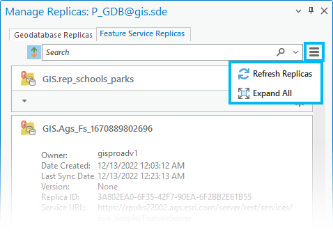

The following commands are accessible from the Manage Replicas Menu Menu:
Feature service replica menu commands
  • Refresh Replicas—Use this to see replicas created, removed, or synchronized since you opened the ArcGIS Pro project.
  • Expand All—Use this option to expand or collapse all replica cards that are displayed on the Feature Service Replicas tab.
    An expanded view of a replica card on the Feature Service Replicas tab shows you general information about the replica.

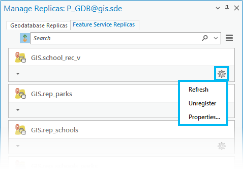

The following commands are accessible from the Feature Service Replicas options button and are applied to that specific replica:
The options button on the Feature Service Replicas tab opens a menu with options to refresh or unregister the replica or open the replica's properties.
  • Refresh—Refreshes the replica. The latest state of the replica's properties are retrieved or updated.
  • Unregister—Unregisters the replica. If a synchronized version exists, it will also be removed.
  • Properties—Opens the Replica Properties dialog box.
