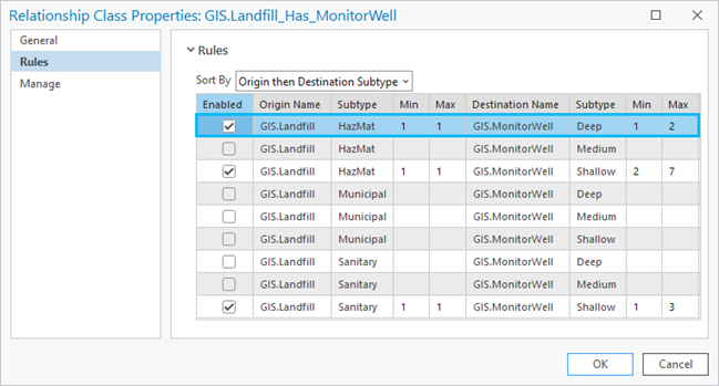

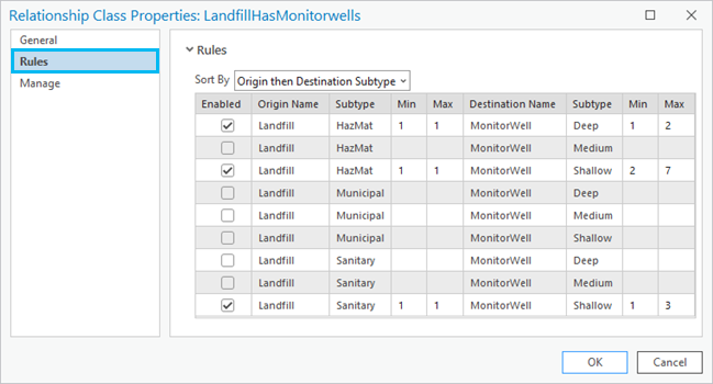

  1. Right-click the relationship class in the Catalog pane to open the Relationship Class Properties dialog box.
  2. Click the Rules tab on the Relationship Class Properties dialog box.
    A list of all of the possible rules that can exist for your relationship class will display.
The Enabled column indicates which of the rules are currently active.
You can sort the relationship class rules by selecting Origin then Destination Subtype or Destination then Origin Subtype in the Sort By drop-down menu.

      1. From the Rules tab, check the Enabled check box for the row that represents the rule you want to add to the relationship class.
      2. If the origin table has subtypes, choose the subtype to which you want to associate a relationship class rule. If the origin class has no subtypes, the relationship rule will apply to all features.
        Add a relationship class rule from the Rules tab on the Relationship Class Properties dialog box.

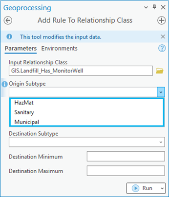

    • If you choose to use the Add Rule To Relationship Class geoprocessing tool, click the link to open the Add Rule To Relationship Class geoprocessing tool.
      1. Click the browse button next to Input Relationship Class to browse to the geodatabase where your relationship class resides. This geodatabase can be a file, mobile, or enterprise geodatabase.
        Tip:
        If the relationship class is stored in an enterprise geodatabase, this tool can only be successfully run by the data owner.
      2. Optionally, for Origin Subtype, if the origin table has subtypes, from the drop-down menu, choose the subtype to which you want to associate a relationship class rule. If the origin class has no subtypes, the relationship rule will apply to all features.
        Add Rule To Relationship Class geoprocessing tool dialog box
  2. Set the appropriate Min and Max cardinalities on the rule for the origin and destination by entering integers in their corresponding cells.
  3. Repeat steps 1 and 2 for each rule that you want to add.
  4. Click Run if using the Add Rule To Relationship Class geoprocessing tool or click OK on the Relationship Class Properties dialog box to apply the changes.

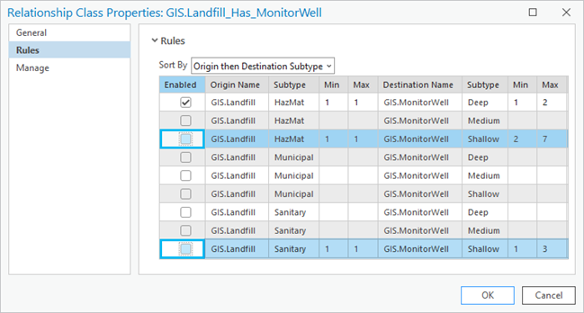

      1. From the Rules tab, uncheck the Enabled check box for the row that represents the rule you want to remove from the relationship class.
      2. If the origin table has subtypes, choose the subtype you want to remove a relationship class rule from.
        Uncheck box to remove a relationship class rule from the Rules tab on the Relationship Class Properties dialog box.
      3. Click OK to complete the changes.

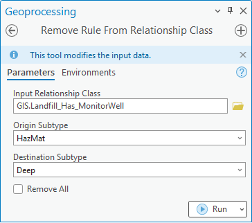

    • If you choose to use the Remove Rule From Relationship Class geoprocessing tool, click the link to open the Remove Rule From Relationship Class geoprocessing tool.
      1. Click the browse button next to Input Relationship Class to browse to the relationship class with the rule to remove. The geodatabase containing the relationship class can be a file, mobile, or enterprise geodatabase.
        Tip:
      2. Optionally, for Origin Subtype, if the origin table has subtypes, from the drop-down menu, choose the subtype you want to remove a relationship class rule from. If the origin class has no subtypes, the relationship rule will apply to all features.
        Remove Rule From Relationship Class geoprocessing tool dialog box
      3. Optionally, for Destination Subtype, if the destination class has subtypes, from the drop-down menu, choose the subtype you want to remove a relationship class rule from.
      4. For Remove All, the following scenarios apply:
        • Checked—All relationship rules will be removed from the input relationship class.
        • Unchecked—Only rules from the origin and destination subtypes specified will be removed. This is the default.
      5. Click Run to complete the changes.
