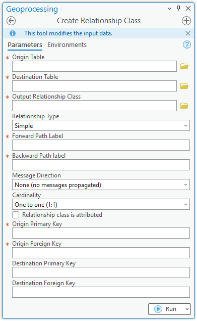

Create Relationship Class tool parameters
How you set the parameter values when you run the Create Relationship Class geoprocessing tool depends on the type of relationship class you need and what rules you may need to apply.
To help you understand what values to use, the following describes the input parameters for the Create Relationship Class geoprocessing tool.
Create Relationship Class tool parameters dialog box
Parameters
The following is an explanation of each parameter on the Create Relationship Class geoprocessing tool:
  • Origin Table—The table or feature class that is associated with the destination table.
  • Destination Table—The table that is associated with the origin table.
  • Output Relationship Class—The name of the relationship class that will be created.
  • Relationship Type—Specifies the type of relationship that will be created between the origin and destination tables.
    • Simple—The origin and destination tables will have a simple relationship. This is the default.
    • Composite—The origin and destination tables will have a composite relationship.
  • Forward Path Label—A name to uniquely identify the relationship when navigating from the origin table to the destination table.
  • Backward Path label—A name to uniquely identify the relationship when navigating from the destination table to the origin table.
  • Message Direction—Specifies the direction in which messages will be passed between the origin and destination tables. For example, in a relationship between poles and transformers, when a pole is deleted, a message will be sent to its related transformer objects indicating that it was deleted.
    • Forward (origin to destination)—Messages will be passed from the origin table to the destination table.
    • None (no messages propagated)—No messages will be passed. This is the default.
  • Cardinality—Specifies how many relationships will exist between rows or features in the origin table and rows or features in the destination table.
    • One to one (1:1)—Each row or feature in the origin table can be related to zero or one row or feature in the destination table. This is the default.
    • One to many (1:M)—Each row or feature in the origin table can be related to one or several rows or features in the destination table.
    • Many to many (M:N)—Several rows or features in the origin table can be related to one or several rows or features in the destination table.
  • Relationship class is attributed—Specifies whether the relationship class will have attributes. See Attributed relationship classes to learn more about where these attributes are stored and how to create and populate an attributed relationship class.
    • Checked—The relationship class will have attributes.
    • Unchecked—The relationship class will not have attributes. This is the default.
  • Origin Primary Key—For one-to-one or one-to-many relationship classes that are not attributed, this is the field in the origin table, often abbreviated as PK, and links to the Origin Foreign Key field in the destination table.
    For many-to-many or attributed relationship classes, this is the field in the origin table that links to the Origin Foreign Key field in the intermediate relationship class table.
  • Origin Foreign Key—For one-to-one or one-to-many relationship classes that are not attributed, this is the field in the destination table, often abbreviated as FK, that links to the Origin Primary Key field in the origin table.
    For one-to-many or attributed relationship classes, this is the field in the intermediate relationship class table that links to the Origin Primary Key field in the origin table.
  • Destination Primary Key—The field in the destination table that links to the Destination Foreign Key field in the intermediate relationship class table. This value is required for many-to-many or attributed relationship classes but should be left empty for one-to-one or one-to-many relationship classes that are not attributed.
  • Destination Foreign Key—The field in the intermediate relationship class table that links to the Destination Primary Key field in the destination table. This value is required for many-to-many or attributed relationship classes but should be left empty for one-to-one or one-to-many relationship classes that are not attributed.

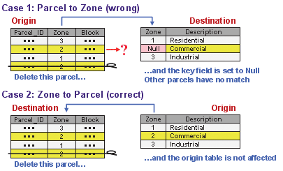

Origin and destination classes
When you create a relationship class, you choose one class to be the origin and another to be the destination. It is important not to confuse the two. With the behavior of cascade deletes in composite relationships, the importance of this may seem obvious.
In simple relationships, getting this correct is critical. This is because when you delete a record in the origin class, the simple relationship class finds the matching records in the destination class and sets the value of their key field to Null. If you choose the wrong class as the origin and delete objects in the origin, you will introduce errors in the foreign key field. The following example illustrates how this can occur:
Case 1 shows a parcel to zone error. Case 2 shows the correct order: zone to parcel.
It is important not to confuse the two in choosing what should be the destination and the origin and vice versa.
Case 1: Parcel to Zone (wrong)
This is a common scenario for this error. The Zone table contains the descriptions for the various zoning codes and is conceptually similar to a lookup table. In this case, the Parcel class is the origin, and the Zone table is the destination. The problem is that when you delete a parcel, the value in the key field (Zone) is set to Null for the matching record in the Zone table, and none of the other parcels that have that zoning code have a match in the Zone table.
Case 2: Zone to Parcel (correct)
To correct the problem, set the Zone table as the origin. Deleting a parcel (a destination object) will have no effect on the Zone table, and deleting a Zone code (an origin object) will simply set the value of the Zone field in the matching parcel records to Null, which is as it should be, because they no longer have a matching Zone table record.
