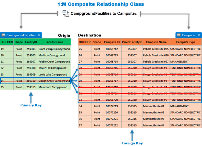

Composite relationship class type
Similar to a simple relationship, a composite relationship class is a type of relationship that associates features in one feature class (origin table) with features in another feature class (destination) or objects in a table. Composite relationships also maintain referential integrity when objects are deleted, but they do so in a different way. In a composite relationship, destination objects can't exist independently of origin objects, so when the origin is deleted, the related destination objects are also deleted in a process called a cascade delete. Composite relationships always have one-to-many cardinality when you create them but can be constrained to be one-to-one with relationship rules.
The following describe a composite relationship class:
  • The cardinality can be one to one (1:1) or one to many (1:M).
  • The relationship is defined between two tables, where one is the origin and the other is the destination.
  • The relationship is based on a common attribute field.
  • The deletion of a feature or row in the origin table does affect the related features or rows in the destination table.
  • Features or rows (objects) in the destination table can't exist independently of related features or rows (objects) in the origin table.
  • The relationship between the tables is maintained as long as the common attribute field values match.
For example, it has been determined that the current location and land of the Slough Creek Campground would be ideal for a new educational center. Therefore the six Slough Creek campsites will no longer be available so that grading and construction crews can begin preparing the site for the new Slough Creek educational center. Now when you edit the composite relationship class and delete the Slough Creek Campground record from the Campground Facilities feature class (origin), all six of the related Slough Creek campsites in the Campsite feature class (destination) are deleted.
Composite one to many relationship class behavior when a parent record is deleted in the origin table and the related destination objects are also deleted
In a composite relationship class, origin objects control destination objects.
A composite relationship can also help you maintain features spatially; moving or rotating an origin feature causes the related destination features to move or rotate with it when messaging is set to Forward.
Learn how to create a composite relationship class
