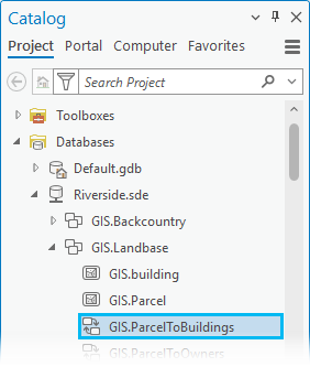

To update the forward and backward path labels for 1:1 or 1:M nonattributed relationship classes, complete the following steps:
  1. In the Catalog pane, in the Databases folder, click the geodatabase connection to expand its contents.
  2. Right-click the relationship class and select Properties.
    Relationship class displayed in the Catalog pane
    The Relationship Class Properties dialog box appears and the Forward Path Label and Backward Path Label are displayed.
