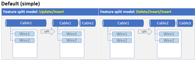

Default (simple)
The default split policy for simple relationship classes is to preserve the relationships on the largest resulting feature after a split. In a relationship class, if the origin feature class uses the default feature class split model, Update/Insert, simple and composite relationship classes share the same behavior for how the related records are associated after a split is complete. In other words, the relationship class on the larger object is preserved after a split.
Relationship class split policy using default for simple relationship class types

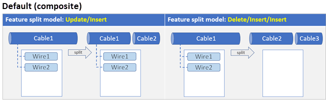

Default (composite)
The default split policy for a composite relationship class depends on the feature class split model set for the origin feature class. If the feature class split model is set to Update/Insert, the relationship will be preserved on the largest resulting feature after a split. If the feature class split model is set to Delete/Insert/Insert, when a feature is split in the origin feature class, the original feature is deleted along with the split parts and their relationship with each other.
Relationship class split policy using default for composite relationship class types

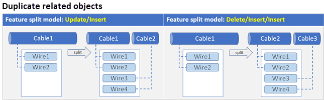

Duplicate related objects
The Duplicate related objects option generates copies of the related objects and assigns them to both resulting parts. When Duplicate related objects is set as the split policy for the relationship class and a feature in the origin feature class is split during the editing process, the records that were originally related to this feature remain related to the largest portion. A new related record is created for each new part, duplicating the same user-set values as the original related record.
Relationship class split policy using duplicate related objects

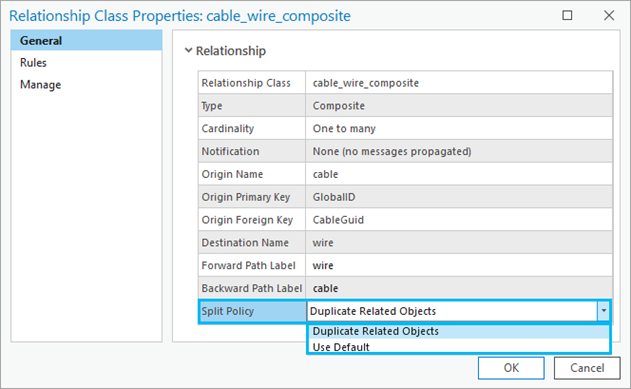

  • Relationship Class Properties—From the General tab on the Relationship Class Properties dialog box, scroll down to Split Policy. Clicking in the cell next to Split Policy enables a drop-down menu. Choosing a split policy from the list populates the Set Relationship Class Split Policy geoprocessing tool and runs it in the background.
    Relationship Class split policy drop-down options

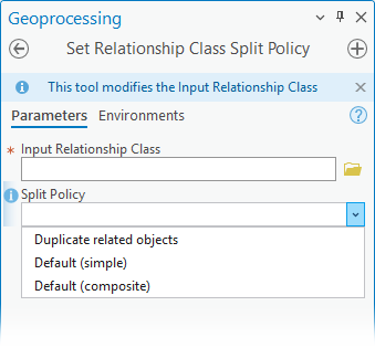

  • Set Relationship Class Split Policy tool—Use the Set Relationship Class Split Policy geoprocessing tool to change the split policy for a relationship class.

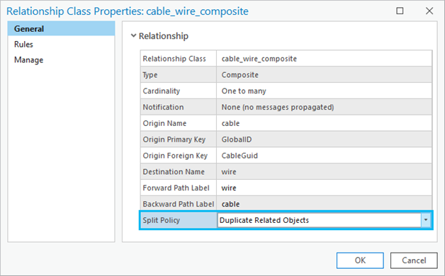

Review the relationship class properties
Follow these steps to review the split policy defined for the relationship class on the Relationship Class Properties dialog box:
  1. Start ArcGIS Pro.
  2. In the Catalog pane, in the Databases folder, click the geodatabase connection to expand it.
  3. Right-click the relationship class and click Properties.
    Relationship class properties
On the General tab, the split policy for the relationship class is at the bottom of the Relationship Class Properties dialog box.
