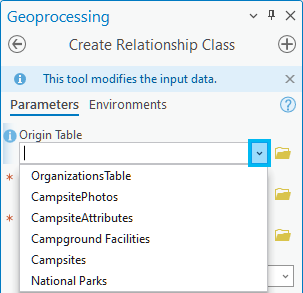

  4. For the Origin Table parameter, you can choose a dataset from the list, or use the browse button to find a dataset.

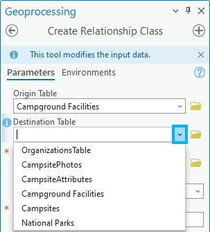

  5. For the Destination Table parameter, you can choose a dataset from the list, or use the browse button to select the dataset.

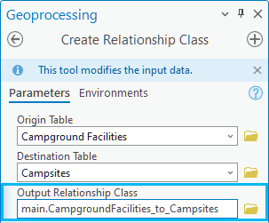

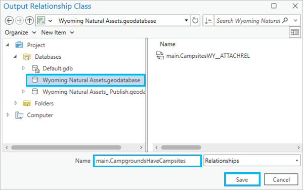

  6. For the Output Relationship Class parameter, click the browse button , browse to the geodatabase where the relationship class will be stored, provide a name for the relationship class in the Name text box, and click Save.
    For this example, the origin and destination tables are located in a mobile geodatabase named Wyoming Natural Assets.geodatabase. The relationship class must also reside in this mobile geodatabase. Since the mobile geodatabase is built on top of SQLite, the main prefix is automatically added to the relationship class name to indicate that it belongs to the main schema, which is the default schema for a SQLitedatabase.
    Naming the output relationship class
    The name of the relationship class is reflected in the Output Relationship Class parameter.
    Populated Output Relationship Class parameter

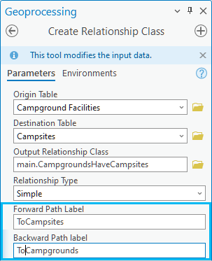

  8. Provide values for the Forward Path Label and Backward Path label parameters.
    The forward path label describes the relationship as it is navigated from the origin class to the destination class, and the backward path label describes the relationship when navigated in the opposite direction, from the destination class to the origin. See Create Relationship Class tool parameters to learn more about these labels.

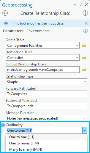

  10. For the Cardinality parameter, choose the cardinality option that is appropriate for the data in the relationship class.
    Cardinality parameter set to One to one
    The cardinality for a relationship class describes how many objects in the origin are related to how many objects in the destination. The following are the Cardinality parameter options:
    • One to one (1:1)—Each row or feature in the origin table can be related to zero or one row or feature in the destination table. This is the default setting.
    • One to many (1:M)—Each row or feature in the origin table can be related to one or more rows or features in the destination table.
    • Many to many (M:N)—Multiple rows or features in the origin table can be related to multiple rows or features in the destination table.
    See Create Relationship Class tool parameters to learn more about cardinality.

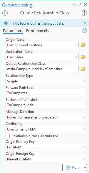

  12. For the Origin Primary Key and Origin Foreign Key parameters, specify a field from the origin table and a field from the destination table, respectively.
    The Origin Primary Key and Origin Foreign Key parameters specify the primary key in the origin feature class and the associated foreign key field in the destination table. For the Origin Foreign Key parameter, only the fields that are the same data type as the field specified for the Origin Primary Key parameter are displayed.
    Create Relationship Class tool parameters populated for a simple relationship class
  13. Click Run to create the relationship class.
