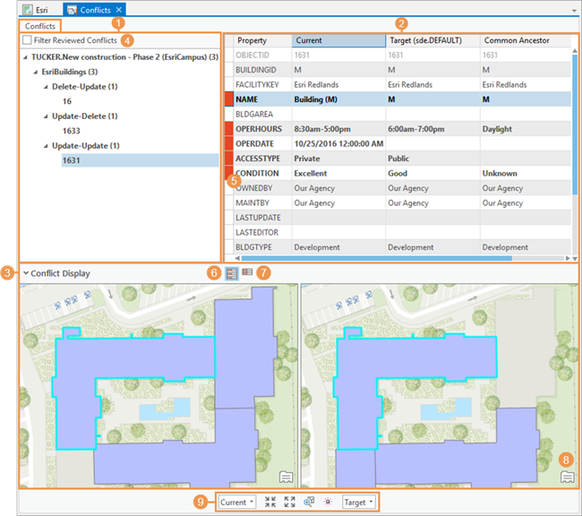

Use the Conflicts view
The Conflicts view lists all workspaces and layers or tables that contain conflicts for all maps in the project. Conflicts are organized by sublayer in the web feature layer, the conflict category (such as update-delete, meaning the feature was updated in the named version but deleted from the default version), and the object ID of the affected feature.
The Conflicts view consists of three main sections for working with conflicts.
  • The list on the Conflicts tab contains the name of the web feature layers that contain conflicts. Under each web feature layer are all the sublayers that contain conflicts. Each feature in conflict is listed under each sublayer, and the features are grouped by the conflict type.
    For example, in the image below, the web feature layer name is New construction - Phase 2 (EsriCampus). There are three conflicts in the entire web feature layer, as indicated by the number after the web feature layer name.
    This web feature layer contains only one sublayer—EsriBuildings. There are three conflicts in this sublayer.
    The three features that contain conflicts are represented by their object IDs and grouped based on the type of conflict. The feature with an object ID value of 16 was deleted from the named version but updated in the default version (Delete-Update). The feature with an object ID value of 1633 was updated in the named version but deleted from the default version. The feature with an object ID value of 1631 was updated in both versions, but the updates were not the same.
  • The information grid shows the attributes and values as they are represented in the named version (Current), default version (Target), and how it was represented before you edited or last reconciled (Common Ancestor). Select the object ID of one of the features in the list to see the attributes and values for that feature.
    Note:
    Attribute fields are listed in the Property column in the information grid.
    For example, in the image below, the feature with an object ID value of 1631 is selected in the conflicts list. The feature was updated in the named version and updated in the default version (Update-Update). All the rows that contain conflicting values are tagged in red.
  • The Conflict Display viewer allows you to visually compare edits made to the selected feature's geometry. In the image below, the selected feature's geometry was not edited, so the feature appears the same for both the named version (Current) and the default version (Target) in the Conflict Display viewer.
In the information grid and the Conflict Display viewer, you can compare the following representations of the selected feature:
  • Current—Represents the current state of the features and attributes in the named version. This includes the edits that you made.
  • Target—Represents the features and their attributes in the default version when you reconciled.
  • Common ancestor—Represents the features and attributes when the named version was created or at the time you last reconciled the named version with the default version.
Reference the image and table below to review the elements of the Conflicts view:
Conflicts view numbered sections and elements
Element
Description
Conflicts list—The conflicts list section contains all layers and features in conflict.
Information grid—The information grid section shows the attributes and values for all representations of the feature that you select from the conflicts list.
Conflict Display viewer—The conflict display viewer is an expandable section at the bottom of the Conflicts view. By displaying the selected feature on maps in the viewer, you can compare edits made to the feature's geometry and visualize the conflict between the two versions. You can also navigate the maps in the viewer independently and identify features in the display.
Filter Reviewed Conflicts—Checking this box at the top of the conflict list filters the list to show only conflicts that have not been reviewed.
See the Mark conflicts as reviewed or not reviewed section below to learn how to review conflicts.

Conflicts list
All layers that contain conflicts and each feature that contains a conflict are shown in the conflicts list. This list shows the total number of conflicts for each web feature layer and each sublayer.
Expand each layer to see the types of conflicts for each feature. These are separated into the following categories:
  • Update-Delete—The feature was updated in the named version and deleted in the default version.
  • Delete-Update—The feature was deleted in the named version and updated in the default version.
  • Update-Update—The feature was updated in both versions.
When you select an individual feature's object ID in the conflict list, the fields and attributes in the Current, Target, and Common Ancestor versions of the feature appear in the information grid.

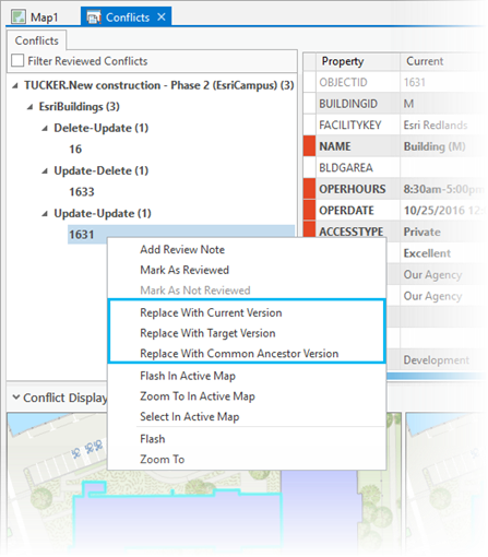

Conflicts context menu for branch version
The following are different levels in which you can use the replacement options to resolve conflicts, and they are based on what you access in the Conflicts view:
  • Attribute replacement
    This occurs at the field level (in the information grid), and you define the attribute values for the current (named) version only.
    To do so, right-click the attribute in conflict in the current version column in the information grid and click a replacement option. To keep the value as represented in the current version, click Replace With Current Version. Alternatively, you can replace the value in the current version with the value from the representation in the default version (Replace With Target Version) or replace it with the value from the common ancestor representation.
  • Feature replacement
    This occurs at the row level. You can replace an entire feature with the representation of the feature in the current, target, or common ancestor representation. This means all attribute values for the feature—including the feature's geometry—are replaced.
    To do this, right-click the feature's object ID in the Conflicts list and click the appropriate replacement option.
