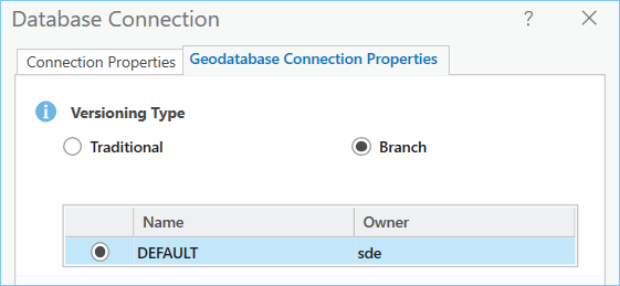

Geodatabase Connection Properties for branch versioning
How you access the geodatabase connection properties varies depending on whether you access it for a new connection or an existing connection.
  1. Access the database connection in the Databases folder of the Catalog pane or Catalog view.
  2. Right-click the database connection and click Geodatabase Connection Properties .
  3. Choose Branch for the Versioning Type option.
    Note:
    Only the default version is available.
  4. Click OK.
The connection file is updated to use branch for the versioning type.
Alternatively, you can use the Update Geodatabase Connection Properties To Branch geoprocessing tool to set the versioning type to branch for the database connection.

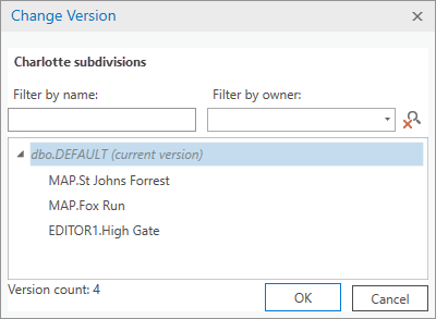

Change the version for the web feature layer
When you add a web feature layer that references registered data to a map, the web feature layer accesses the data in the default version. If the web feature layer has the version management capability enabled, you can use the Change Version dialog box to change the data source to a named version. When you change versions, all layers in the map that share the same data source are changed to access the data in the version you select.
To change the version accessed by a web feature layer in the active map, complete the following steps:
  1. On the Versioning tab, in the Data Source group, ensure the desired web feature layer data source is chosen from the drop-down menu.
  2. In the Versioning group, click the Change Version button .
    If you want to change to the default version when accessing a named version for the data source, you can bypass the Change Version dialog box by clicking Change To Default .
    Note:
    • If you have unsaved edits, you will be prompted to save or discard edits before changing the version.
  3. Choose a version from the list and click OK.
    You can also double-click the version name to change to that version.
When you change from one version to another, all layers in the web feature layer in the map change to the version you choose.
Dive in:
You can also create a version on the Versioning tab and change to this new version for active map layers.
