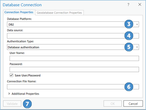

Follow the steps below to connect to a Db2 database using the Database Connection dialog box in ArcGIS Pro.
The Database Connection dialog box
  1. Open the Catalog pane in ArcGIS Pro.
  2. Right-click Databases or a folder under Folders and click New Database Connection.
  3. Choose DB2 from the Database Platform drop-down list.
  4. Type the data source name in the Data source text box. If the database is not cataloged, use the following syntax to connect instead:
    HostName=<host>;Port=<port number>;Database=<database name>;
    Specify the host, port, and database name appropriate for your connection.
    For example, if your Db2 database is on server cube, communicating through DBMS port 50000, and the database name is spatialdata, the connection string would be as follows:
    HostName=cube;Port=50000;Database=spatialdata;
    After you validate the connection or create the database connection file, the port number and database name will appear under Additional Properties.
  5. Choose the type of authentication to use when connecting to the database: Database authentication or Operating system authentication.
    • If you choose Operating system authentication, you do not need to type a username and password—the connection is made using the login name and password used to sign in to the operating system. If the login used for the operating system is not a valid database login, the connection fails.
    • If you choose Database authentication, you must provide a valid username and password in the User name and Password text boxes, respectively. Usernames can be a maximum of 30 characters.
      Uncheck Save user name and password if you prefer not to save your login information as part of the connection; doing this can help maintain the security of the database. However, if you do this, you will be prompted to provide a username and password every time you connect.
    Note:
    Save user name and password must be checked for connection files that use database authentication to provide ArcGIS web services with access to the database and to search ArcGIS Pro to locate data accessed through this connection file.
  6. Provide a name for the connection file in the Connection File Name field.
    A default name is created based on the connection property values. You can use the default, or provide a more descriptive file name.
    This is the name that will appear in the Catalog pane and view, and the name of the .sde file stored on disk.
  7. Click Validate to confirm that the connection information is valid and the database is accessible.
    If the database contains a geodatabase and the connection is valid, the Geodatabase Properties tab is now active. If necessary, you can alter geodatabase connection properties to connect to a traditional version other than the default version, configure the connection as a branch version connection, or connect to a historical moment.
  8. Click OK to create the connection file.
A database connection appears under Databases in the Catalog pane, and a connection file (.sde) is created in the ArcGIS Pro project directory.
