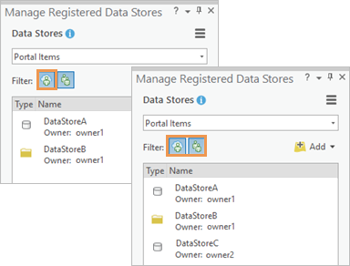

  3. Click the Shared With Me button to see data stores in the portal that are shared with you.
    Two views of the Manage Registered Data Stores pane
    You can display data stores that you own, data stores that are shared with you, or both, depending on how you filter the view.
