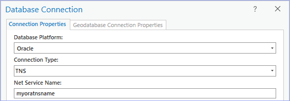

    • TNS—Choose this option if you configured the Oracle client to use TNS connections on each ArcGIS client machine.
      In the Net Service Name field, type the net service name that you defined in the tnsnames.ora file.
      In the following example, the net service name is defined as myoratnsname in the tnsnames.ora file:
      Connecting to Oracle using the net service name myoratnsname

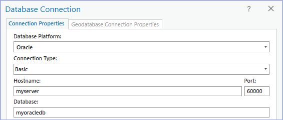

  5. If you use the basic connection type, provide the following information:
    1. If the Oracle instance is not listening on the default Oracle port number, type the nondefault port number in the Port field.
    2. Type one of the following in the Hostname text box:
      • The name of the Oracle server, for example, myserver.
      • The IP address of the Oracle server, for example, 10:10:10:10. For IPV6 addresses, place brackets around the address, for example, [4000:ab5:0:0:f666:d191:77f5:e2bd].
      • A URL containing the Oracle server name, for example, //myserver.
    3. Type the Oracle service name or ID in the Database field.
    In the following example, the Oracle server name is myserver, the Oracle service name is myoracledb, and communication takes place over port 60000.
    Connection to an Oracle database using Easy Connect information for a server named myserver and service name myoracledb using a nondefault port of 60000
