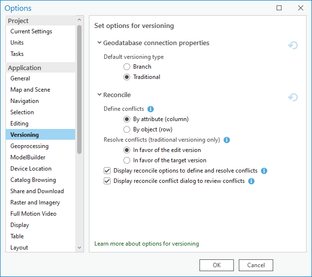

On the project Options dialog box, on the Versioning tab, you can change versioning settings for the ArcGIS Pro application. The versioning settings are stored in your user profile and are honored for all ArcGIS Pro projects.
Versioning Options tab from ArcGIS Pro project settings

  2. On the Options dialog box, under the Application heading, click the Versioning tab.
  3. Click OK.
    Your settings are saved and the dialog box closes.
Review the Geodatabase connection properties options and Reconcile options sections below for more details about each of the settings available.
The geodatabase connection properties section provides an option to control the default versioning type for database connections that are established for enterprise geodatabases using the Database Connection dialog box.
Default versioning type
You can set the default versioning type for database connections to use.
  • Branch—The versioning type for database connections is branch.
  • Traditional—The versioning type for database connections is traditional. This is the default setting.
Reconcile options
The reconcile section provides several options to control how conflicts are defined and resolved. Additionally, there are settings to control which prompts are received when performing reconcile operations.
To learn more, see Reconcile and post edits to a branch version and Reconcile and post edits to a traditional version.
Define conflicts
You can define a conflict as a discrepancy between corresponding attribute fields or between object geometry and attributes in a database row.
  • By attribute (by column)—Only changes to the same attribute (column) of the same row or feature in the target and edit versions will be flagged as a conflict. This is the default setting.
  • By object (by row)—Any changes to the same row or feature in the target and edit versions will be flagged as a conflict.
Resolve conflicts
You can set version conflicts to be resolved in favor of the edited version or the target version.
Note:
For branch versioning, conflicts will only be resolved in favor of the edited version.
  • In favor of the edit version—All conflicting features in the current version take precedence over conflicting representations in the target version. This is the default setting.
  • In favor of the target version—All conflicting features in the current version are replaced by their representations in the target version.
Display reconcile options to define and resolve conflicts
When performing a reconcile, you can set a preference for displaying the prompt to choose how to define and resolve conflicts.
Display reconcile options to define and resolve conflicts:
  • Checked (Default)—Each reconcile will provide a prompt to choose how to define and resolve conflicts.
  • Unchecked—Reconcile options are not displayed for how to define and resolve conflicts and the project options are used.
Display the Conflict Manager dialog box to review conflicts
When conflicts are detected during reconcile, they are initially resolved in favor of the edit or target version. An additional dialog box is presented to give an option to display the Conflict Manager dialog box to review the conflicts interactively. You can decide to show or hide this prompt.
Display the Conflict Manager dialog box to review conflicts:
  • Checked (Default)—When conflicts are present during the reconcile, provide a dialog box to show the Conflicts view.
  • Unchecked—When conflicts are present during the reconcile, do not provide a dialog box to review conflicts.
