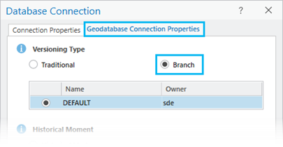

  • Prior to specifying the Input Dataset value, owners must verify that Versioning Type is set to Branch in Geodatabase Connection Properties dialog.
    Geodatabase Connection Properties dialog box

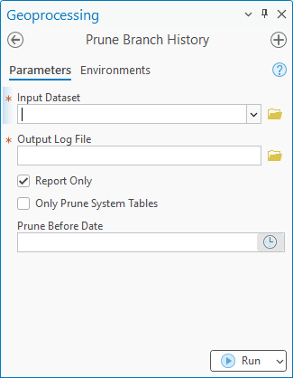

  1. To open the Prune Branch History geoprocessing tool, browse to the Analysis tab and click Tools in the Geoprocessing group. Alternatively, search for the tool in the Data Management Tools toolset in the Versions toolbox.
    Prune Branch History tool under the Analysis tab, Tools, and Geoprocessing
    The Prune Branch History geoprocessing tool dialog box appears with default settings.
  2. For Input Dataset, from the drop-down menu, select a single dataset or use the browse button to choose a feature dataset, feature class, or table containing branch versioned data that will be pruned.
  3. For Output Log File, use the browse button to specify where the output log file will be saved.

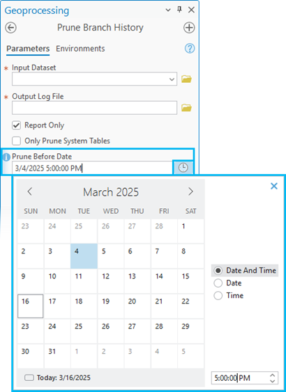

  6. Optionally, set a value for the Prune Before Date parameter to prune archived records dated before a specified date and time.
    Tip:
    Ensure the date is in UTC (Coordinated Universal Time) to maintain a consistent reference.
    • If the Prune Before Date field is empty, the tool will prune as much of the eligible archive history as possible based on referenced moments.
      Prune Branch History tool with no Prune Before Date specified
    • If the Prune Before Date field contains a specified date, only archived data up to that moment will be removed.
      Available options for setting the Prune Before Data parameter using the Prune Branch History tool

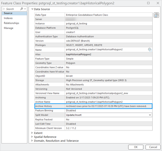

Once the Prune Branch History tool completes, open the properties dialog box of your table or feature class. Under the Source tab, the Archive History parameter shows the most recent date the tool was used to prune retired rows from this dataset.
Archive History parameter in the Feature class properties dialog box
