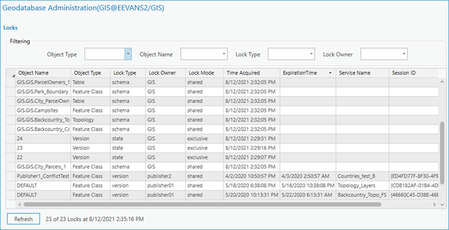

Locks view
The Locks view allows you to see the locks applied to enterprise geodatabase objects for which you are the dataset owner, traditional version owner, or geodatabase administrator. Columns for these geodatabase objects reflect the properties of each lock acquired.
These lock properties include the following:
Object Name—The name of the object being locked.Object Type—The type of object, such as a table, feature class, or version that is locked.Lock Type—Lock types are used to provide concurrent data access while simultaneously protecting the data. Depending on the registration type of the dataset and the operation, the following lock types can be applied:Schemalocks—Used when an operation dependent on the schema of an object is executed. For example, a shared schema lock is acquired anytime a dataset is opened in ArcGIS Pro. By default, schema locking is enabled on objects locked by services to prevent modifications to the source dataset schemas while the service is running.Statelocks—State locks are maintained by the enterprise geodatabase when a traditional versioned dataset is accessed to prevent states from being deleted or modified while a client application is accessing or using the state.Versionlocks—Aversionlock type is acquired either from editing a traditional versioned dataset from a database connection or from viewing or editing a branch versioned dataset from a service.Note:

Lock Owner—The user who is accessing or modifying the object that generates the lock.Lock Mode—The lock mode determines the type of access permitted for the lock owner and for concurrent users of the locked object. The lock mode differs based on the operation being performed and the versioning type for the dataset. The following lock modes are available in a geodatabase:Sharedlock—Operations that allow more than one user to access or read an object require a shared lock. A shared lock prevents any other operation from obtaining an exclusive lock.Exclusivelock—Operations that modify an object (for example, INSERT, UPDATE, or DELETE) and must prevent concurrent users from accessing or updating the object require an exclusive lock. An exclusive lock prevents any other operation from acquiring a lock on that object until the exclusive lock has been released.
Time Acquired—The date and time the lock was acquired on an object.Service Name—The name of the service that caused the lock to be acquired. As stated above, this field is populated for branch versioned services only. Other web services acquire locks on geodatabase objects, but the service names do not appear on this interface.ExpirationTime—The date and time the lock will expire. If the lock expires, the lock entry may still be present in the database, though it would not block another lock from being acquired. The lock will be removed from the database once another valid lock is acquired against the version. The lock expiration time is extended while the session is still active.Session ID—The client-generatedsessionIDis a GUID value established for the duration of the session on the version and represents the token used to lock the version.Tip:

Manage locks
Geodatabase administrators can see who is holding schema, version, and state locks for all items in the geodatabase using the Locks tab of the Geodatabase Administration dialog box. The geodatabase administrator can also remove the connections that are holding locks to free the resource for use.
Note:
You cannot remove an individual lock; you can only disconnect the user, thereby removing all locks held by that user.
Start ArcGIS Pro and connect to the geodatabase as the geodatabase administrator.
Right-click the database connection in the Catalog pane and click Administration > Locks.
The Locks list on the Geodatabase Administration dialog box opens.
Use the drop-down menus at the top to filter locks by object type, object name, lock type, or lock owner.
Contact the users who hold the locks that need to be released and ask them to finish their transactions and disconnect from the geodatabase. If someone holding a lock is gone for the day and the lock needs to be released immediately, you can disconnect them.
