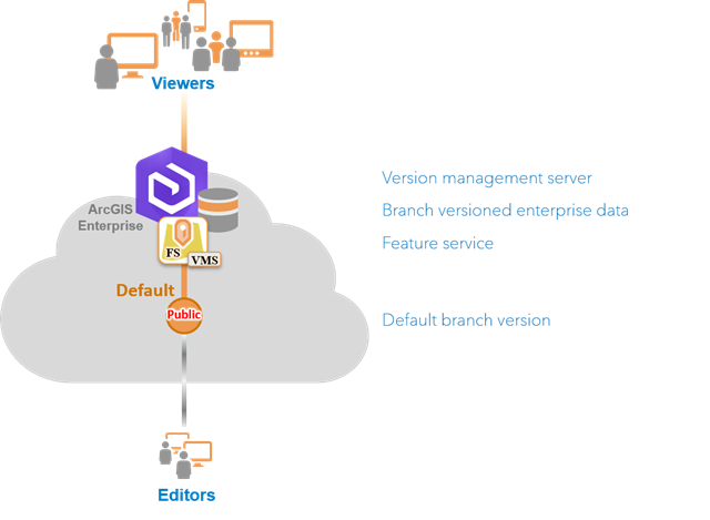

Edit data in the default version
To allow others to edit data in the default version, publish the branch versioned data. The web feature layer automatically references the default version of the data.
When editing data in the default version, edits are saved immediately to the underlying data source. Editing data in the default branch version is equivalent to standard database short transactions. When editing data in the default branch version, your first edit begins the transaction, and the individual edit operations you perform are each automatically committed to the database as a single transaction without needing to save the edits. The changes you make are available to all other users and applications accessing the web feature layer from the default version when your transaction is complete.
Branch version data published with version management (VMS) enabled
If version access to the default version (orange) is set to public, editors can edit the data in the default version, which is the published version. Viewers who access this published web feature layer (feature service) with version management enabled also see the updates made to the default version.
Version access is based on a combination of the active portal user's privileges and the access permission configured for the version. The portal user privileges and the version access permission level (public or protected) of the default version determine the types of editing workflows permitted.
  • Public—If the access level of the default version is set to public, all portal users can edit the data in the default version, and users who edit data in named versions can post their edits to the default version. This is the default access setting for the default version.
  • Protected—If the access level of the default version is set to protected, only users who are the version administrator (portal users with higher privileges) can edit data in the default version or post data edits from named versions to the default version. All other editors must create a named version to begin editing.

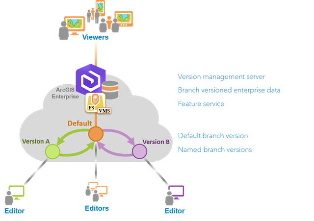

Edit a named version
If you manage multiple projects, work orders, or jobs, you need a structured approach to workflow management. Discrete work units involving many edit sessions and spanning numerous days, weeks, or months can be maintained without affecting the default version. Examples of these discrete work units are a highway improvement scheme, the installation of a new phone service, or an ongoing maintenance project for a gas pipeline. When a work order or project is initiated, to isolate edits, you can create a named version from the default version.
Branch versioning allows only one level of named versions to be created from the default branch version. To work with branch versioned datasets in a named version and have them participate in versioning workflows, do the following:
  • Enable the Version Management capability when you publish the branch versioned data. Once enabled, the version management service (VMS) exposes capabilities to create, modify, and delete named versions, as well as reconcile and post edits from named versions to the default version. This is necessary to support web feature layers that work with branch versioned datasets.
  • Create a named version to provide editors their own unique, isolated view to work with the same data at the same time, and allow you to identify and resolve conflicts before posting edits to the default version.

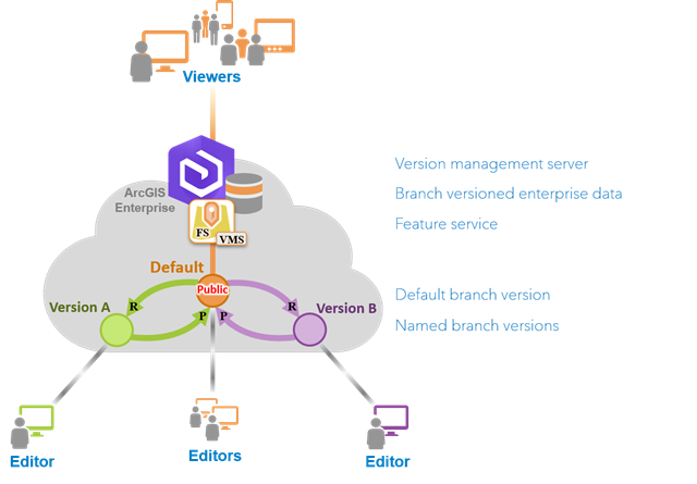

Editing the default and named branch versions when the default version is set to public
If version access to the default version (orange) is set to public, editors can edit the data in the default version, or they can create and edit a named version, such as Version A (green) or Version B (purple). Then editors can reconcile (R) and post (P) their edits from the named version to the published default version. Viewers who access this published web feature layer (feature service) with version management enabled see the updates made or posted to the default version.
If you choose a strategy in which no one edits the default version directly, the geodatabase administrator can modify the default version properties and set the version access level to protected, allowing users to continue to view the data in the default version but restricting their access level to read-only. Any editor wanting to modify the data must create a named version and edit the data in it.

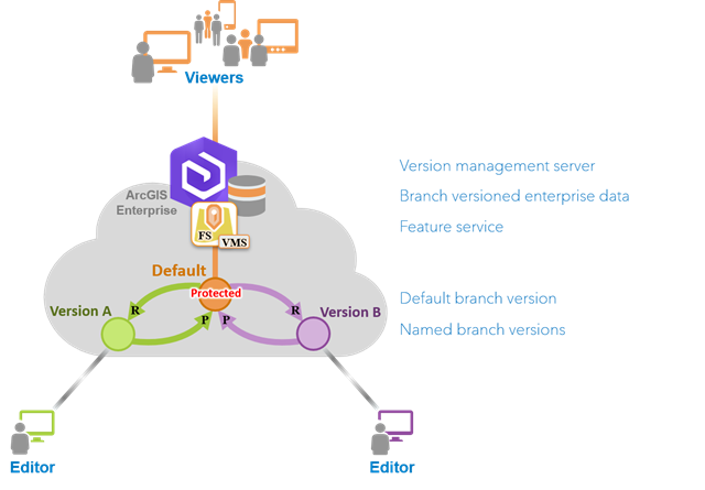

Editing the named branch versions when the default version is set to protected
If version access to the default version (orange) is set to protected, editors can only edit data in a named version, such as Version A (green) or Version B (purple). Editors can reconcile (R) their edits and version administrators can post (P) the edits to the protected default version. Viewers who access this published web feature layer (feature service) with version management enabled see the updates posted to the default version.
When a web feature layer with the Version Management capability enabled is initially added to the map from a portal connection, it accesses the default version. However, you can use the Change Version dialog box to switch between versions. When you edit a web feature layer with Version Management enabled, you can edit the data in either the default version or a named version if one exists. When editing data in a named version, you can undo and redo individual edits as well as save or discard groups of edits. To access these editing capabilities in a named version, the version being edited must be isolated from other editors and viewers. To accomplish this, ArcGIS Pro provides locking mechanisms to limit access to versions for viewing or editing.
The locking model differs slightly depending on the ArcGIS Enterprise version.
For ArcGIS Enterprise 11.5 and earlier, the locking model allows for multiple simultaneous viewers or a single editor as follows:
  • Once an editor begins editing data in a named version, an exclusive lock is obtained. No other users can connect to the version during the edit session.
  • At the time an editor starts editing data in a named version, they must be the only user connected to that version.
For ArcGIS Enterprise 12.0 and later, the locking model allows for multiple simultaneous viewers and a single editor as follows:
  • Once an editor begins editing data in a named version, an exclusive lock is obtained. Other users can connect and read the version during the edit session as long as the editor has not reconciled during the edit session.
  • At the time an editor starts to reconcile data in a named version, they must be the only user connected to that version.
To avoid some of this locking, set the access permission on the named version to private. A named version with the access permission set to private prevents other users, with the exception of users with elevated privileges (for example, the portal administrator and the version administrator), from connecting to this version.

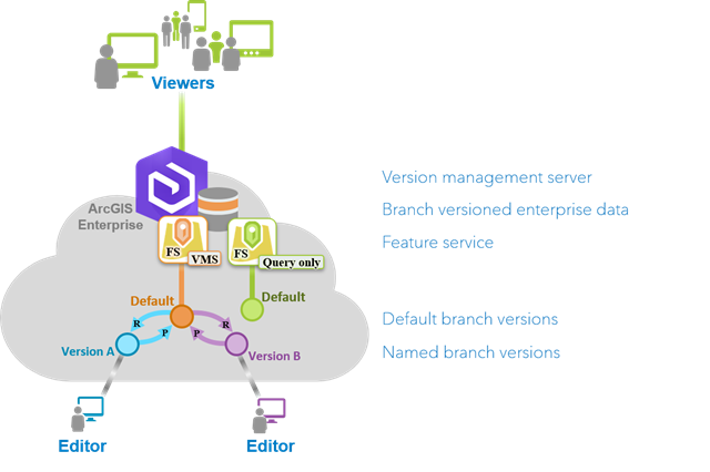

Support editors and viewers
If your organization needs to support multiple tiers of users, each requiring different operations, the recommended approach is to create one web feature layer for each level of user. For example, you may have editors and viewers who need access to the versioned data. In this scenario, you can support these editors and viewers by publishing two web feature layers (feature services) from the same underlying feature class registered as branch versioned.
Using branch versioned data supports editors and viewers by publishing a query-only feature service and an editable feature service.
Once editors post edits to the Default version (orange) in the editable web feature layer (feature service), these edits are reflected in the underlying feature class registered as branch versioned. They are visible to viewers who are accessing the noneditable web feature layer (green), as this web feature layer is also published from the same underlying feature class.
  • Publish the first web feature layer is as an editable web feature layer with the Version Management capability enabled. Share this web feature layer with a group whose members are allowed to edit the data.
    After the first web feature layer is published, the editors can either edit the data in the default branch version or edit the data in a named version and reconcile and post their edits. When edits have been completed and, if necessary, posted to the default version, the changes are immediately available in the default version. These edits will be available for the web feature layer you publish for read-only users below.
  • Publish a second web feature layer with the query capability enabled and the create, update, delete, export, and sync operations disabled. When publishing this web feature layer, which does not have editing enabled, you can leave the Version Management capability disabled. Share this web feature layer, which does not have editing enabled, with a group whose members only require a read-only view of the data in the default version or share with your organization to allow all organization members a read-only view of the data in the default version.
