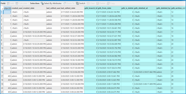

To manage all edits (inserts, updates, and deletes), the following six specific system fields are added to the business table of the branch-versioned feature class or table:
  • GDB_BRANCH_ID—Identifies the version where the edit was made.
  • GDB_FROM_DATE—Records the exact date and time when an edit is made.
  • GDB_IS_DELETE—Indicates whether a feature has been deleted, using a binary value (0 for not deleted and 1 or 2 for deleted).
  • GDB_DELETED_AT—Records the date and time when a feature is deleted.
  • GDB_DELETED_BY—Records the user who deleted the feature.
  • GDB_ARCHIVE_OID—Uniquely identifies each row in the table, tracking every edit with a distinct ID.
Branch versioning archive history fields
Note:
The GDB_DELETED_AT and GDB_DELETED_BY fields are added to the feature class or table and allow tracking of deletions; these work in conjunction with the standard editor tracking fields.
