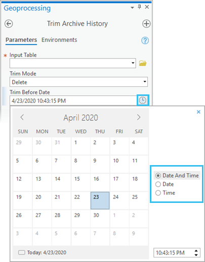

  4. Optionally, provide a value for Trim Before Date. The following options are available:
    Trim Archive History tool with the Trim Before Date options
    • If the Trim Before Date parameter is left empty, the tool will attempt to delete all retired rows, and if any of the rows are referenced by a replica that has not already synced those rows, the operation will fail.
    • If the Trim Before Date parameter is populated with some value, the tool will attempt to delete retired rows that are older than the input date. If the retired rows are referenced by a replica that has not already synced those rows, you must input an earlier trim before date or unregister the replica.

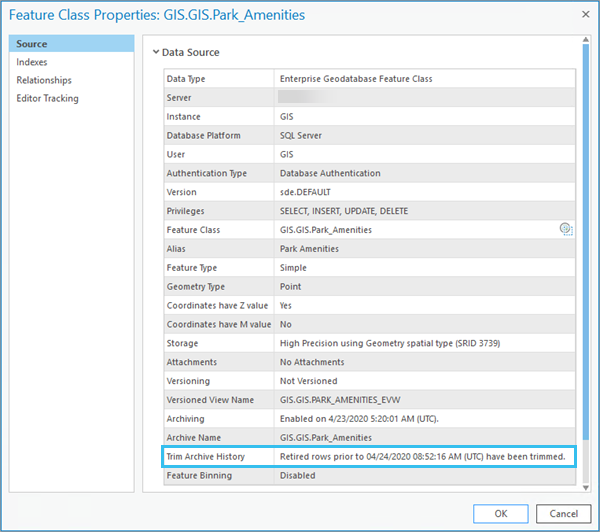

If the input dataset or related datasets have no rows to trim, the Trim Archive History tool will successfully complete and return a warning for any tables that had no rows trimmed. Once the trim completes, you can access the last trimmed date of a dataset on the Source tab on the feature class or table properties dialog box. In addition, on the Source tab, you can also see the Archiving property with the data and time (UTC) archiving enabled and the Archive Name property populated.
The feature class properties display when the Trim Archive History geoprocessing tool was last run.
