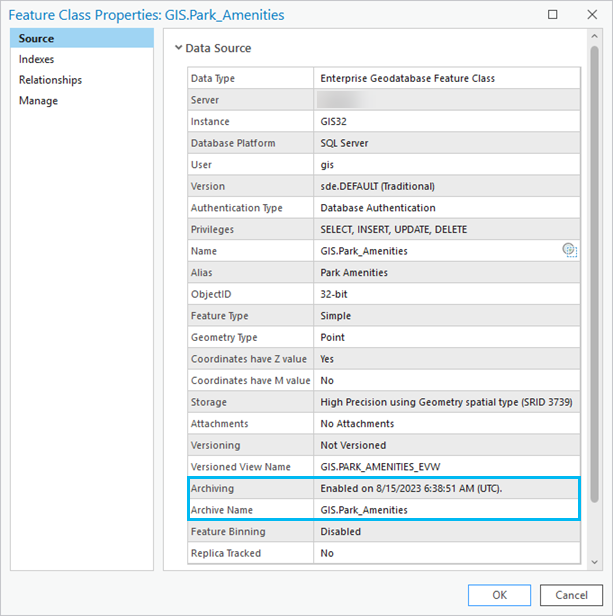

Follow these steps to determine if archiving is enabled on a dataset by accessing the dataset properties:
  1. Start ArcGIS Pro.
  2. In the Catalog pane, in the Databases folder, click the geodatabase connection to expand its contents.
  3. Right-click the feature class or table and select Properties.
    If archiving is enabled, the Archiving property on the Source tab reflects the date and time, in coordinated universal time (UTC), archiving was enabled, and the Archive Name property is populated.
    Feature class properties of a feature class with archiving enabled
    Note:
    If archiving is not enabled, you can enable it on versioned or nonversioned data by right-clicking the dataset in the Catalog pane and click Manage. From the feature class properties dialog, click the Manage tab, under Manage geodatabase functionality, click Archiving.
