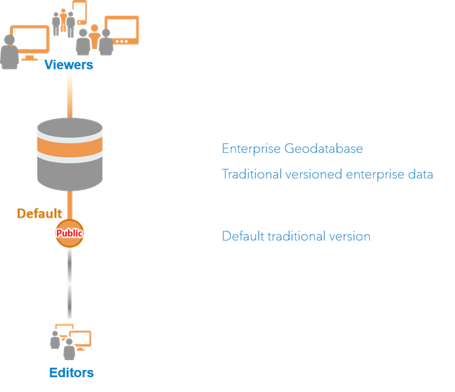

Edit the default version
The default version is the initial version created when data is registered as traditional versioned. When you use traditional versioning and the version access is set to public, multiple editors can concurrently edit and view data using the default version. The simplest way to support multiuser editing is to allow multiple editors to edit the default version directly.
Editing the default traditional version
If version access to the Default version (orange) is set to public, editors can edit the Default version directly. Viewers who connect to the default version see the updates made to the Default version.
As each editor starts editing the default version, an unnamed, temporary version is automatically created in the edit session. This temporary version is accessible only to the current editor. When the editor saves or ends the edit session, the changes recorded in the temporary version are posted to the default version.

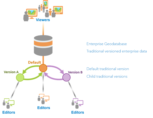

Edit a child version
If you're managing multiple projects, work orders, or jobs, you'll require a structured approach to workflow management. Discrete work units involving many edit sessions and spanning numerous days, weeks, or months can be maintained without affecting the default version. Examples of these discrete work units are a highway improvement scheme, the installation of a new phone service, or an ongoing maintenance project for a gas pipeline.
If you're using traditional versioning, when a work order or project is initiated, a version is created as a child of the default version.

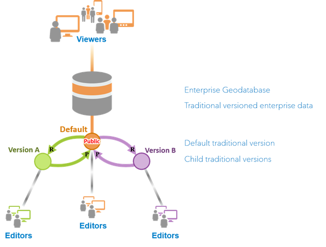

Editing the default and child traditional versions when the default version is set to public
If version access to the Default version (orange) is set to public, editors can edit the Default version directly or they can create and edit a child version, such as Version A (green) or Version B (purple). Then editors can reconcile (R) and post (P) their edits to the Default version. Viewers who connect to the default version see the updates made or posted to the Default version.
One or more editors can work on this version until the work order or project is complete. When all the modifications to a child version have been completed, an editor or administrator reconciles with the default version, resolving any conflicts. The modifications to the default version are then posted, integrating the modifications into the published database. At this point, the child version can be removed.

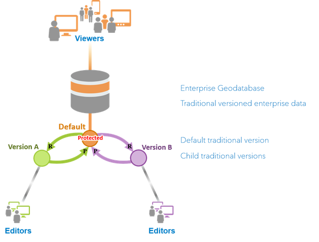

User access permissions to the default version can be restricted to enforce this workflow and ensure that the default version is not modified. The administrator can set the permission of the default version to protected, allowing users to continue to view the default version but restricting their access level to read-only. Any editor wanting to modify the data must create a new child version.
Editing the default and child traditional versions when the default version is set to protected
If version access to the Default version (orange) is set to protected, editors can only make edits to a child version, such as Version A (green) or Version B (purple). Editors can reconcile (R) and post (P) their edits to the protected Default version and viewers who connect to the default version see the updates made or posted to the Default version.

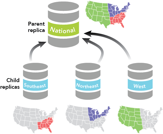

For example, some projects require two or more distant offices to work on the same data. Each office requires local access to the database, so each creates a copy of the database. When a change is made to the data in one office location, the change must also be applied to the data in the other office location. To keep the copies of the databases synchronized, the offices can transfer changes between each other on a scheduled basis. This capability is referred to as geodatabase replication.
Example of centralizing data from many sources when used as a possible distributed data scenario
