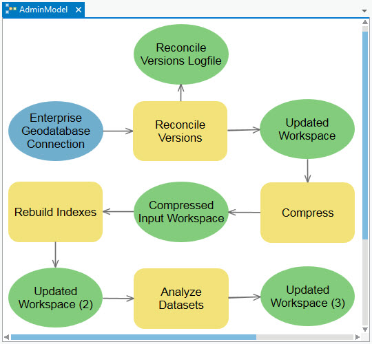

Model
If you put all of these geoprocessing tools in a model in ModelBuilder, it will resemble the following:
Model of a recommended version administration workflow
To run this workflow as a nightly task, you can run these tools in a Python script and create a scheduled task in Windows.
