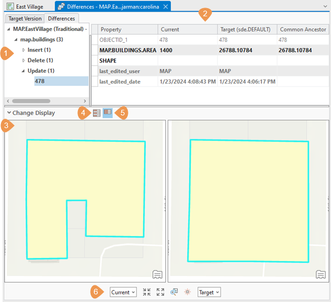

Differences view
The numbers in the image above correspond to the numbers in the following table:

Differences list—The differences list section contains all the layers and features that have differences.
Information grid—The information grid section shows the attributes and values for all representations of the feature that you select from the differences list. Attribute values displayed in bold signify that edits made in the current version contain differences. Attribute values that are bold and shaded refer to system-maintained fields that contain differences.
Change Display viewer—The Change Display viewer is an expandable section at the bottom of the Differences view. By displaying the selected feature on maps in the viewer, you can compare edits made to the feature's geometry and visualize the conflict between the two versions. You can also navigate the maps in the viewer independently and identify features in the display.
Show All Show All fields —Displays all the fields for the feature.
5
Show Differences Show only fields in conflict —Displays only those fields that have differences.
6
Change Display navigation tools—The following tools allow you to navigate and control the version displayed and navigate in the change display windows:
  • Two drop-down menus, one for each display window, allow you to change the display to show the Current, Target, or Common Ancestor representation for the selected feature.
  • Zoom In Fixed Zoom In—Zooms in to show the map at a larger scale, which increases the size of the features but shows less area.
  • Zoom Out Fixed Zoom Out—Zooms out to show the map at a smaller scale, which decreases the size of the features but shows more area.
  • Zoom To Selected Zoom To Results—Zooms the map to center on the selected feature.
  • Flash Selected Flash—The selected feature briefly flashes in blue and changes to red in the Change Display viewer.

Differences list
All layers that contain differences are shown in the differences list. This list shows the total number of differences for each layer and each sublayer (shown in parentheses).
Click the expand button for each layer to see the types of differences for each feature. These are separated into the following categories:
  • Insert—The feature was inserted in the current version.
  • Delete—The feature was deleted in the current version.
  • Update—The feature was updated in the current version.
When you select an individual feature's object ID in the differences list, the fields and attributes in the Current, Target, and Common Ancestor representation of the feature appear in the information grid.

Information grid
In the information grid, you can view the different representations of attribute values for the selected feature. Having the attributes and values for all representations of a feature with differences allows you to compare how the attribute values differ between versions. Attribute values displayed in bold signify that edits made in the current version are different than those made in the target version.
Below the information grid, you can use the Show All Show All fields and Show Differences Show only fields in conflict buttons to change the fields displayed in the information grid.
Click the arrow next to the Change Display label to open the Change Display viewer at the bottom of the Differences view. This allows you to compare the changes to the selected feature's geometry as they appear on a map, as well as navigate and identify features in the display.
Use the drop-down menus at the bottom of the viewer to compare the feature's representation using the following options:
  • Current—Compare to the current version.
  • Target—Compare to the state of the feature in the target version.
  • Common ancestor—Compare to the state of the feature in the current version before it was edited.
