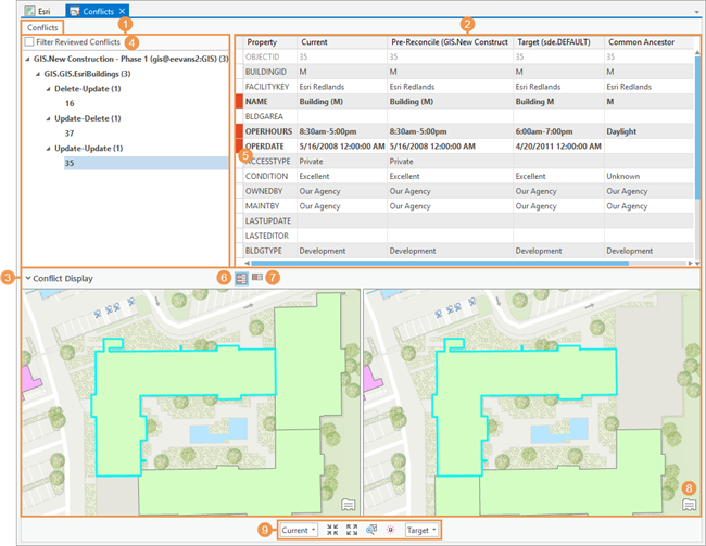

The Conflicts view contains all the conflict classes and their features or rows in conflict. Conflicts are organized using the data source, class, conflict category, and ObjectID. Workspaces for all maps in the project are listed in the Conflicts view. The conflict classes represent the classes in conflict for the entire geodatabase.
The Conflicts view consists of three main sections for working with conflicts. The Conflicts list contains all conflict classes and features in conflict. The information grid shows the attributes and values for all representations of the feature in conflict selected from the Conflicts list. The Conflict Display viewer is used to view and compare the different representations for geometry edits in a map.
Reference the image and table below to review the elements of the Conflicts view:
Traditional versioning Conflicts view numbered sections and elements
Element
Description
Conflicts list—The conflicts list section contains all conflict classes and features in conflict.
Information grid—The information grid section shows the attributes and values for all representations of the feature in conflict.
Conflict Display viewer—The Conflict Display button opens the conflict display viewer section at the bottom of the Conflicts view. This allows you to view the conflicts as they appear on the map, as well as navigate and identify features in the display.
Filter Reviewed Conflicts—Checking this box at the top of the conflict list filters the list to show only conflicts that have not been reviewed.
5
Red indicator—A red indicator to the left of the row identifies a conflict. For example, if the feature's geometry was edited in each version, a red indicator appears next to the Shape field.
  • When conflicts are defined by object—All edited rows are bold and have a red indicator.
  • When conflicts are defined by attribute—All edited rows are bold, but only rows in conflict have a red indicator.
6
Show All Show All fields —Allows you to view all the fields.
7
Show Conflicts Show only fields in conflict —Allows you to view only those fields that are in conflict.
8
Show credits for service layers—Clicking this button opens a dialog box listing the providers and makers of the basemap.
9
Conflict Display navigation tools—The following tools allow you to navigate and control the version displayed and navigate within the conflict display windows:
  • Two drop-down menus, one for each display window, allow you to change the display to show the Current, Pre-Reconcile, Target, or Common Ancestor version.
  • Zoom In Fixed Zoom In—Applies a fixed zoom in on the map.
  • Zoom Out Fixed Zoom Out—Applies a fixed zoom out on the map.
  • Zoom To Selected Zoom To Results—Zoom the map to center on the selected object.
  • Flash Selected Flash—The selected object will briefly flash blue and change to red in the Conflict Display viewer.
Elements of the Conflicts view
Conflicts list
All conflict classes and features are shown in the conflicts list on the upper left side of the Conflicts view.
Click an object drop-down arrow to see the conflicts for each feature. These are separated into the following categories:
  • Update-Delete—The feature was updated in the current version and deleted in the target version.
  • Delete-Update—The feature was deleted in the current version and updated in the target version.
  • Update-Update—The feature was updated in both the current and target versions.
When you select an individual feature's ObjectID in the conflict list, the fields and attributes in the Current, Pre-Reconcile, Target, and Common Ancestor versions of the feature appear in the information grid on the right side of the Conflicts view.
Tip:
Conflicts that have not been reviewed are shown in bold. Conflicts that have been reviewed are no longer bold.
Information grid
In the Information grid, you can view the different representations of attribute values for a selected feature. Having the attributes and values for all representations of a feature in conflict allows you to see how the attribute values differ across versions and helps you determine the representation of the data to preserve. All fields are displayed in the information grid and a red indicator appears to the left of the row for attributes that are in conflict.
The following columns display attribute values for different representations of the feature:
  • Current—Represents the current state of the features and attributes in the named version. This includes any edits that you made.
  • Pre-Reconcile—Represents how features appeared in your version prior to reconciliation.
  • Target—Represents the features and their attributes in the target version.
  • Common ancestor—Represents the features and attributes when the version was initially created or at the time of the last reconcile operation.
Tip:
All fields are displayed in the information grid within the Conflicts view; however, fields with a field-level conflict filter applied are not identified as in conflict and do not display a red indicator.
Conflict Display
The Conflict Display button opens the conflict display viewer section at the bottom of the Conflicts view. The conflict display viewer allows you to view conflicts as they appear on the map, as well as navigate and identify features in the display. The conflicts displayed are based on the individual feature's ObjectID selected in the conflict list.
The conflict display navigation tools are located below the Conflict Display viewer. These tools contain two drop-down menus that allow you to change the versions being compared, where the version options include the Current, Pre-Reconcile, Target, or Common Ancestor version.
The content in the conflict display differs depending on whether the conflict class is present in the active map:
  • When the conflict class is in the active map, the conflict display shows all map layers, uses the map symbology, and includes the basemap.
  • When the conflict class is not in the active map, the conflict display only shows the layer in conflict, uses the default symbology, and does not include the basemap.

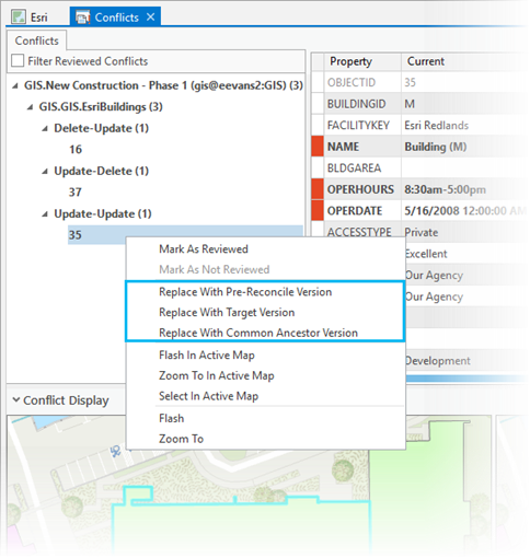

Resolve conflicts
When you resolve conflicts, you are deciding which representation of the features and attributes you want to keep. Regardless of which version you opted to reconcile in favor of—the target or your edited version—you can specify which representation to keep: either the current representation (how it appeared in your version before reconciliation), target representation (how it appears in changes made by another editor), or common ancestor representation (how the feature or attribute is in the target version).
From the Conflicts view, right-click a version, dataset, feature, or attribute and select one of the following replacement options:
  • Replace With Pre-Reconcile Version
  • Replace With Target Version
  • Replace With Common Ancestor Version
Conflict context menu for traditional version
The following are different levels in which you can use the replacement options to resolve conflicts:
  • Attribute replacement—This occurs at the field level. If there are conflicts in attributes, you can replace just the attribute value in the current version with one from the current, prereconcile, target, or common ancestor representation. To do this, right-click the attribute in conflict and click the option you want from the menu.
  • Feature replacement—This occurs at the row level. You can replace an entire feature with the representation of the feature in the current, prereconcile, target, or common ancestor version. This means any fields in conflict are replaced.
  • Class-level replacement—You can choose to replace the current representation of the entire feature class with either the current, prereconcile, target, or common ancestor version representation to resolve the conflict. This replaces all the conflicting features and attributes at once, allowing you to quickly update and replace conflicting features. If there are multiple features in the Conflicts list, all of them are replaced with the version you choose.
    To choose a class-level replacement option, right-click the feature class name in the Conflicts list and click whichever version you want to use.
  • Complete replacement—This is root-level replacement. Using this replacement option replaces all conflicting features and feature classes in the list with the designated representation. If you have multiple feature classes and multiple objects in conflict, all of them are replaced with the version you choose.
    Right-click the version and connection information at the top of the Conflicts list and click the version with which you want to replace all conflicts.
  • Merge geometries—This occurs at the field level and is associated specifically with the Shape attribute. The option to merge geometries is only available on the Shape context menu when there is a conflict concerning the Shape field. If two editors both edit the geometry of the same feature but do not edit the same area of that feature, they have the option to resolve the conflict by merging geometries and accepting both edits. Once the geometries are merged, the end result is a feature that contains the edits made by both editors.
    If the edits made by one editor share a region that was also edited by another editor, their edited areas will overlap. Although merging geometries may be an option, trying to do so will fail with the following error message: Error found while merging geometries. Cannot merge the two geometries. The edited regions overlap.
