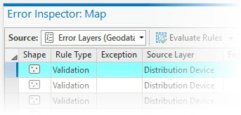

  4. On the Edit tab, in the Manage Edits group, click Error Inspector .
    The Error Inspector pane appears, and the Source option on the Error Inspector toolbar references the error layers in the map view.
    The Source option references the error layers in the map view.
