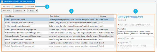

Navigational sections
When you open the Attribute Rules view, you can view the various rule types by clicking the Calculation, Constraint, or Validation tab. Existing rules are displayed on each tab with each row representing an individual rule. When you select a rule, the rule properties appear in the details pane on the right side of the view.
Configure the Attribute Rules view using the Columns and Filter buttons. You can modify the visible columns in the rule list using the Columns button. You can also filter the attribute rules by rule properties using the Filter button. The filter uses the visible columns in the rule list.
Element
Description
Use tabs to switch between the Calculation, Constraint, and Validation rule types.
Rules are listed in the grid section of the view. You can customize the columns to show more or less detail for each rule.
The details pane includes the properties of the selected rule from the grid and is also used to enter properties during the creation of rules.
Navigational sections of the Attribute Rules view
