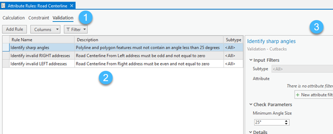

Configure the Attribute Rules view using the Columns and Filter buttons. You can modify the visible columns in the rule list using the Columns button. You can also filter the attribute rules by rule properties using the Filter button. The filter uses the visible columns in the rule list.
Navigational sections of the Attribute Rules view
Tabs are used to switch between the Calculation, Constraint, and Validation rule types.
Rules are listed in the grid section of the view. The columns can be customized to show more or less detail for each rule.
The pane includes the parameters of the chosen rule from the grid and is also used to choose properties during the creation of rules.

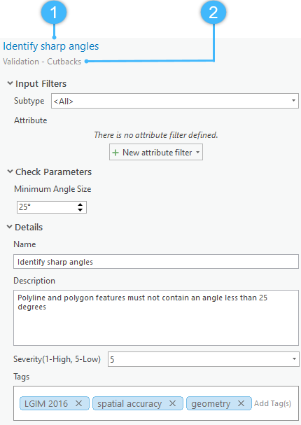

The rule's pane, in the Attribute Rules view, displays input parameters for the rule and varies depending on the type of check used to implement the rule. You can view details about each parameter by hovering over the information icon next to the parameter.
Pane for attribute rule
Rule and check type

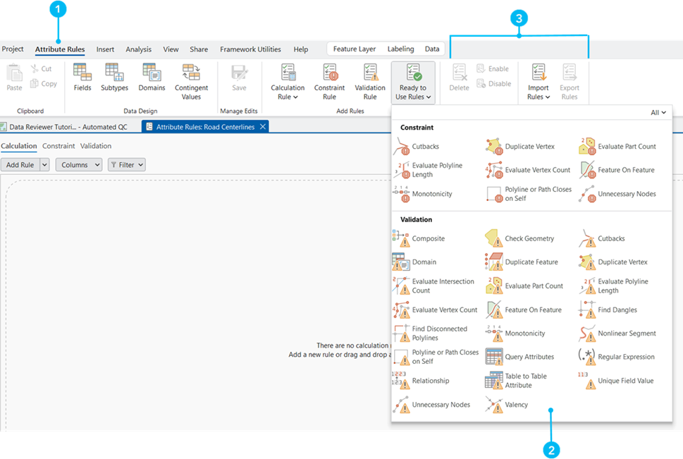

The Attribute Rules tab contains tools for creating and managing attribute rules. The tab is automatically displayed when the Attribute Rules view is active.
Attribute Rules tab
Attribute Rules tab
Ready to Use Rules, which contain Reviewer checks
Rule management tools

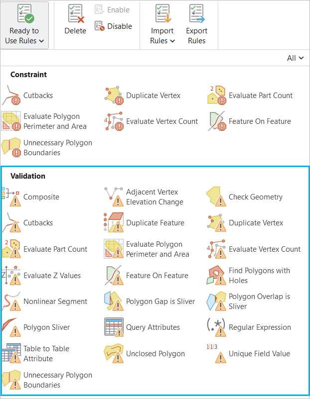

  5. On the Attribute Rules tab, click Ready to Use Rules and click the check from the Validation gallery group required to implement the rule.
    Ready to Use Rules gallery with the Validation checks section highlighted
    Note:
    The contents of the Ready to Use Rules gallery varies depending on the chosen data source.

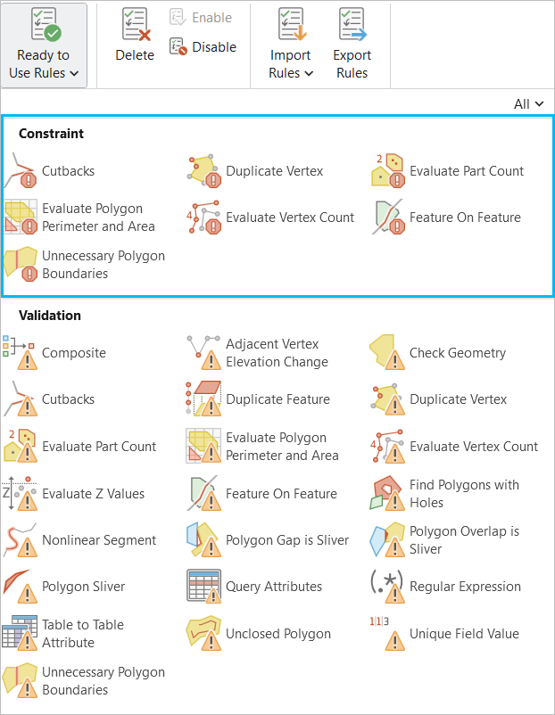

  4. On the Attribute Rules tab, click Ready to Use Rules and click the check from the Constraint gallery group.
    Ready to Use Rules gallery with the constraint checks section highlighted
    Note:
