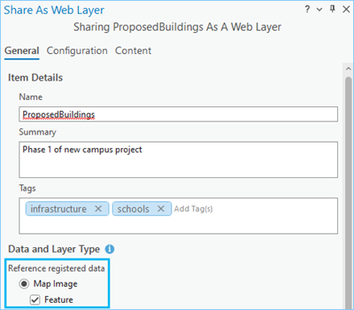

    On the General tab of the Share As Web Layer pane under Reference registered data, ensure the Map Image and Feature options are chosen as shown in the example below.
    Map Image and Feature options under Reference registered data to publish branch versioned data
