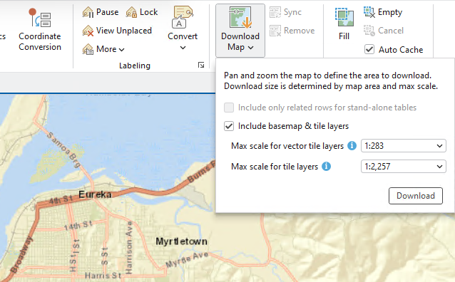

On the Map tab on the ribbon, in the Offline group, click Download Map
.Optionally, check the Include only related rows for stand-alone tables and Include basemap & tile layers check boxes.
The Include only related rows for stand-alone tables option is available only if a related stand-alone table in the map can be taken offline. Enabling this option when downloading the map will only download rows in stand-alone destination tables that relate to features in the current map extent.
The options Include basemap & tile layers and Max scale for vector tile layers are discussed in the next section.
Click Download.
.Check the Include basemap & tile layers check box to take these layers offline.
This option is available only if a basemap or tile layer in the map can be taken offline.

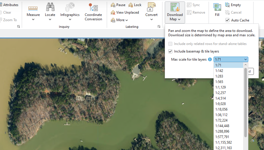

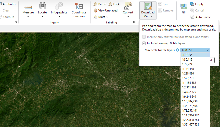

Click the Max scale for vector tile layers drop-down list and choose the largest scale you want to use to download vector tile layers.
Click the Max scale for tile layers drop-down list and choose the largest scale you want to use to download tile layers and imagery layers.
Optionally, zoom in or out on the map to change the scale to use to take tiles offline, and choose a different scale for downloading tiles.
Click Download.

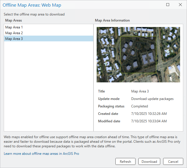

To take map areas prepared ahead of time offline, complete the following steps:
In the Catalog pane, click the Portal tab.
Alternatively, with a catalog view active, click Portal
in the Contents pane.Browse to or search for a web map or web scene in My Content or another portal collection.
Right-click the web map, and click View Offline Map Areas.
In the Offline Map Areas window, select the desired map area.
The Refresh button can be used to view the most current content of offline map areas and their status.
Click Download.
