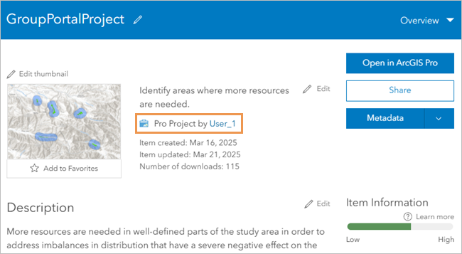

In the portal application, a portal project is identified with a Pro Project label on its item description page and in the project owner's My Content collection.
Portal project item page in a browser window

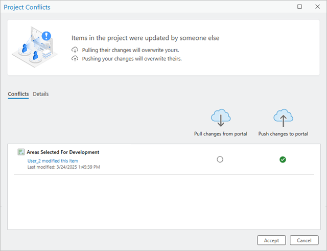

Portal projects are not intervisible. When you open the project, you do not know who else is working on the project—in their own local copies—or what changes they may be making. Notifications about work done by others appear only when your uploaded changes conflict with theirs.
For example, you and a colleague may both change the same map in different ways. Because you are each working in a local copy, neither of you sees the other’s change in real time. When your colleague saves their local copy of the project, their change is uploaded to the portal. When you save your local copy later, your change does not automatically overwrite your colleague’s change. Instead, a conflict is detected, and the Project Conflicts dialog box appears. You must decide whether to resolve the conflict by pushing your change to the portal or by pulling your colleague's change from the portal. Because you cannot see your colleague’s change, you may need to contact them before deciding.
Conflicts are detected and resolved at the level of the project item, such as the map, layout, or report. For example, a conflict arises if you change the symbology of a map layer and a colleague makes an unrelated change to the same map, such as adding a new layer, changing the basemap, or changing the map’s coordinate system. In other words, it is the project items that are in conflict—not their individual settings, properties, or elements.
When you resolve the conflict, either your map or your colleague’s map is saved in its entirety to the portal.
If you push changes, your Areas Selected For Development map is uploaded and replaces the map your colleague saved to the portal. If you pull changes, your colleague’s map remains on the portal and is downloaded to your local project.
When conflicts are detected, no changes are uploaded or downloaded until the conflicts are resolved. After you resolve conflicts, all nonconflicting changes are processed along with the changes that were in conflict. For example, after you resolve conflicts in Map 1, your changes to Map 2—which did not have conflicts—are also uploaded to the portal. In addition, your colleague’s changes to Map 3—which did not have conflicts—are downloaded from the portal to your local copy of the project.
Learn more about resolving conflicts
