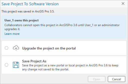

  1. Open the project.
    Save Project To Software Version dialog box for the project owner or administrator
    The dialog box identifies the ArcGIS Pro version in which the project is saved and the project owner.
    The Save Project To Software Version dialog box appears with an option to upgrade the portal project.
  2. On the Save Project To Software Version dialog box, click Upgrade the project on the portal and click Open.
    Alternatively, click Save Project As to save the project as a new project.
  3. If prompted, repair default project items as needed and click OK on the Project Item Repair dialog box.
    The portal project opens. On the portal, it is upgraded to the new software version and can no longer be opened in earlier versions.

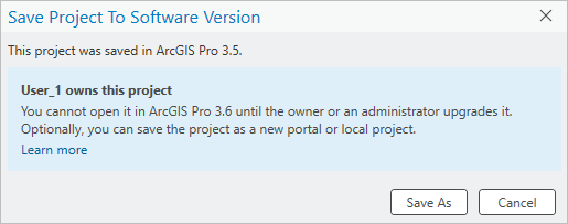

  1. Open a portal project.
    Save Project To Software Version message box for a user other than the project owner
    The message box identifies the ArcGIS Pro version in which the project is saved and the project owner.
    The Save Project To Software Version message box appears.
  2. On the Save Project To Software Version message box, click Save As and do one of the following:
    • On the Save Project As dialog box, browse to My Content. Type a name for the project and click OK.
    • On the Save Project As dialog box, browse to a folder on your computer or a network share. Type a name for the project and click OK.
    Alternatively, click Cancel if you do not want to save the portal project as a new project.
    The new project opens.
