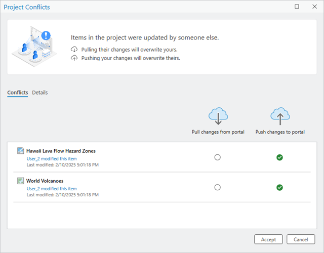

Resolve conflicts
If conflicts are detected, you must resolve them before any content can be uploaded or downloaded. When a conflict is detected, the Project Conflicts dialog box appears.
You resolve conflicts by pushing your changes to the portal or by pulling changes previously uploaded to the portal by others. The Push changes to portal option replaces items in the portal project with the corresponding items from your local project. The Pull changes from portal option replaces items in your local project with the corresponding items from the portal.
You can resolve conflicts by pushing your changes, by pulling changes made by others, or by a combination of the two. After you resolve conflicts, both conflict items and other items are uploaded and downloaded as appropriate and the save is complete.
To resolve conflicts, complete the following steps:
  1. In an open project, click Save on the Quick Access Toolbar to save the project.
    In this example, changes made to a layout and a map by the current user are in conflict with changes previously uploaded to the portal by User_2.
    The Project Conflicts dialog box appears. By default, the Push changes to portal option is selected for conflicts.

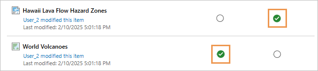

  2. Choose how to resolve conflicts:
    • Keep the default setting to resolve conflicts by pushing all your changes to the portal.
    • Click Pull changes from portal to resolve conflicts by pulling all changes from the portal.
      Project Conflicts dialog box showing the Pull changes from portal button selected
    • Click an option next to a conflict to push or pull changes on a case-by-case basis.
      Project Conflicts dialog box showing two conflicts with different resolutions

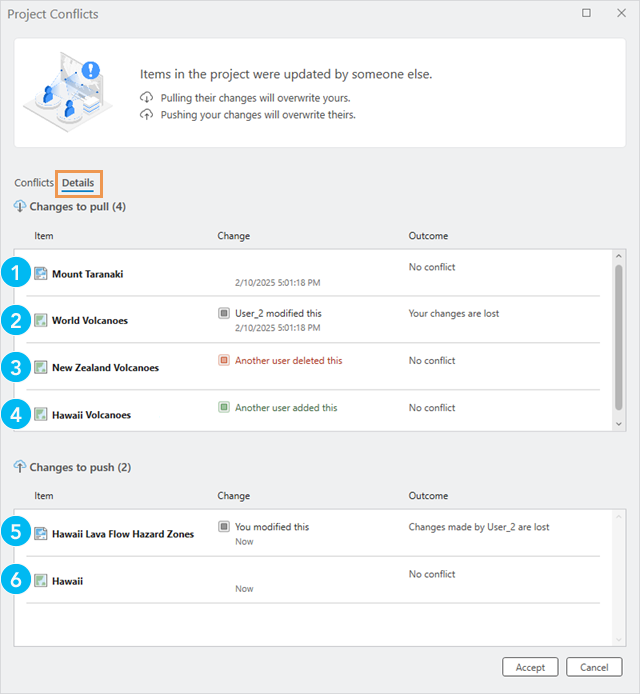

  3. Click the Details tab.
    The Details tab shows all items that will be pushed or pulled, including conflict items and other items.
    Details tab of the Project Conflicts dialog box
    In this example, four changes by other users will be pulled from the portal and two will be pushed to the portal by you.
    Element
    Description
    Another user changed a layout named Mount Taranaki. You did not change this item, so the change is pulled without a conflict.
    User_2 changed a map named World Volcanoes. You also changed this map. On the Conflicts tab, you chose to pull the change, which means that your change is lost.
    Another user deleted a map named New Zealand Volcanoes. You did not change this map, so the change is pulled without a conflict. This means the map will be deleted from the project.
    Another user added a map named Hawaii Volcanoes. Because it is a new item, it is pulled without a conflict.
    5
    You changed a layout named Hawaii Lava Flow Hazard Zones. User_2 also changed this layout. On the Conflicts tab, you chose to push your change, which means that the change made by User_2 is lost.
    6
    You changed a map named Hawaii. No one else changed this item, so your change is pushed without a conflict.
    Explanation of items on the Details tab

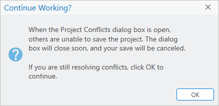

    The project is locked while the Conflict Resolution dialog box is open. If the dialog box is left open for five minutes, a Continue Working prompt appears.
    You can click OK on the Continue Working prompt to keep the Conflict Resolution dialog box open for another five minutes. You can repeat this process as often as necessary; however, the project remains locked for others during this time. If you do not click OK, the prompt disappears after one minute and the Project Conflicts dialog box closes. A message indicates that the project was not saved.
