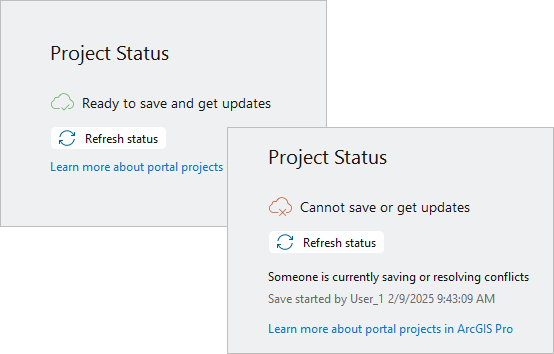

In the Project Status section in the second column, you can see whether the project is ready to save or is currently locked by another user who is saving the project or resolving conflicts.
Two images of the project status on the Info page.
In the first image, the project is ready to save. In the second image, another user is currently saving or resolving conflicts.
The project status is correct when you access the Info page, but it does not update automatically. For example, the Cannot save or get updates message does not change when a collaborator finishes resolving conflicts. Click Refresh status to update the status.

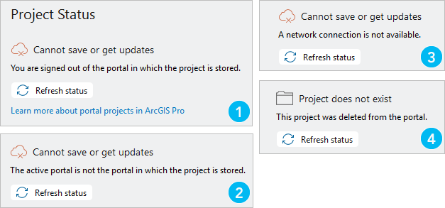

You may be unable to save a project or get updates for a number of reasons as the following status messages indicate.
Portal project status messages on the Info page
Element
Message
Solution
You are signed out of the portal in which the project is stored.
Sign in to your ArcGIS Enterprise portal.
This message also appears if you lose connectivity to a VPN. In this case, you may need to reconnect or wait for connectivity to be restored.
The active portal is not the portal in which the project is stored.
Make your Enterprise portal active and sign in if necessary.
A network connection is not available.
You may need to wait for internet access to be restored.
This project was deleted from the portal.
Save the open project as a new local project or a new portal project.

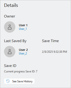

In the Details section, you can see who owns the project, who saved it last, and the time at which it was saved. Save ID indicates the number of times the project has been saved. For example, if Save ID is 7, the project has been saved eight times. (The first save ID is 0.)
The Details section of the Info page

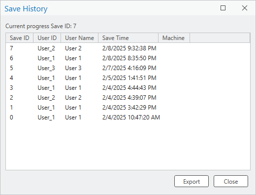

You can click See Save History to open a dialog box that lists every save to the project. You can export the save history to a .csv file.
Save History dialog box

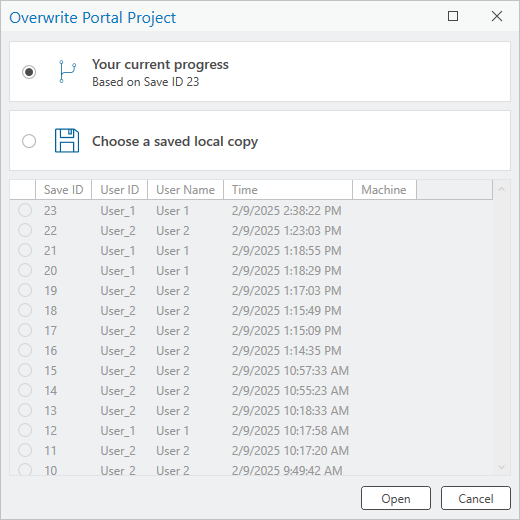

  3. In the Maintenance section, under Overwrite Project, click Overwrite .
    Overwrite Portal Project dialog box with the current progress option selected
    Machine names were removed from the image.
    The Overwrite Portal Project dialog box appears.
  4. Choose one of the following options:
    • Your current progress—This overwrites the portal project with the current unsaved state of your open project. This is the default.

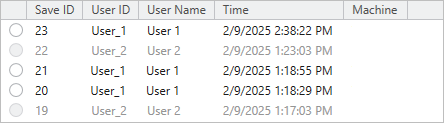

    • Choose a saved local copy—Your three most recent saved copies of the project are available. Click one of the available project copies to select it.
      Available saved local copies of the project
    A message appears at the bottom of the dialog box if other users have saved copies that are more recent than yours. It is usually best to overwrite the project with the most recent saved copy.
