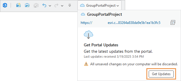

  1. In an open project, click the project name drop-down arrow and click Get Updates.
    Get Updates button on project name drop-down window
