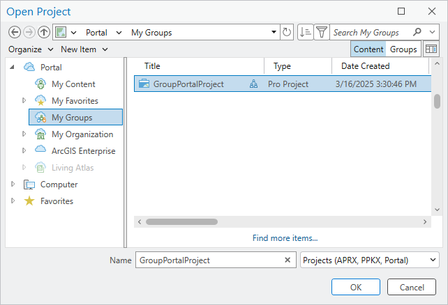

  2. On the Open Project dialog box, in the navigation pane, under Portal, click a portal collection, such as My Content or My Groups .
  3. In the contents list, click a project to select it, or use the search box at the top of the dialog box to search for a project.
    Open Project dialog box with a portal project selected
  4. Click OK.
    The project is downloaded to your computer and opens.

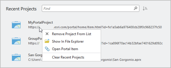

    You can also right-click a portal project in the recent projects list to open the location of the local copy of the project in File Explorer or to open the project’s item details page on the portal.
    Recent Projects list showing the context menu for a portal project
