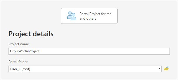

    Project details page of the wizard
    On the Project details page, the project name and portal folder appear. By default, the project is saved to the root level of your portal content.
  9. Optionally, in the Project name text box, provide a different name for the project.
  10. Optionally, click the Portal folder drop-down arrow and choose a different folder in My Content.
    Alternatively, click Browse and browse to a folder in My Content, or create a folder from the New Item drop-down list on the New Project Location browse dialog box.

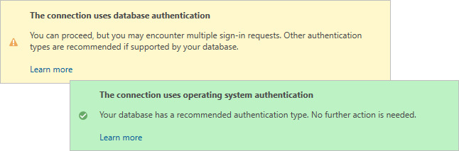

  14. Optionally, click Check to check the database authentication type.
    Depending on the authentication type, different messages appear.
    Two different database authentication messages displayed together
    If the database connection uses database authentication, you may be required to validate your credentials frequently when you work with a portal project. For this reason, other authentication types are recommended if available.

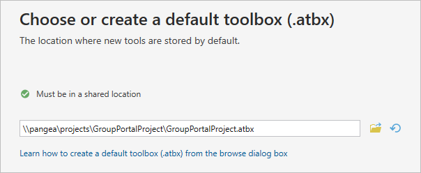

  15. Click Next. On the Choose or create a default toolbox (.atbx) page, specify a toolbox in one of the following ways:
    • In the input box, type a UNC path to an existing toolbox on a network drive accessible to all users who will work with the project.
    • Click Browse and browse to an existing toolbox on a network drive accessible to all users. Click a toolbox to select it, and click OK.
    • Click Browse and browse to a network drive accessible to all computers. On the browse dialog box, click the New Item drop-down list and click Toolbox (.atbx). Rename the new item, confirm that it is selected, and click OK.
    Default toolbox page of the wizard
    The green check mark is enabled only when the required conditions are met. Every collaboration type requires that the default toolbox be an ArcGIS toolbox with the .atbx file extension.

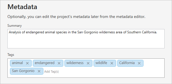

  16. Click Next. On the Metadata page, add a summary and tags.
    Metadata page of the wizard

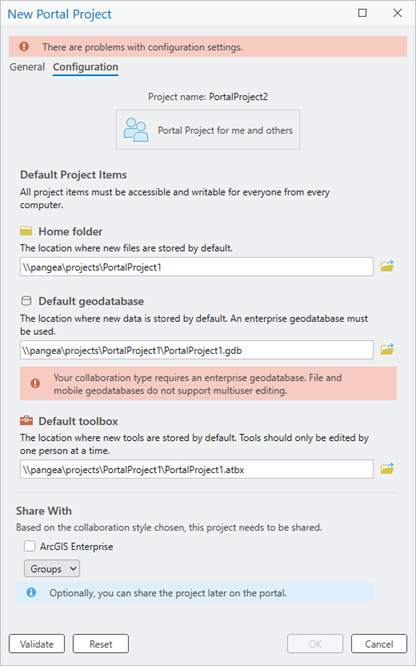

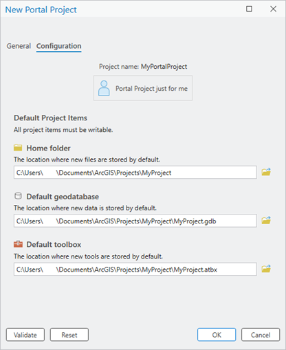

  10. At the top of the dialog box, click the Configuration tab.
    When you create a portal project, you must specify the paths to the home folder, default geodatabase, and default toolbox, and create these items if necessary.
  11. In the Home folder text box, specify a home folder in one of the following ways:
    • In the text box, type a UNC path to an existing folder on a network drive accessible to all users who will work with the project.
    • Click Browse and browse to an existing folder on a network drive accessible to all users. Click a folder to select it, and click OK.
    • Click Browse and browse to a network drive accessible to all users. On the browse dialog box, click the New Item drop-down list and click Folder. Rename the new folder, confirm that it is selected, and click OK.
    An error message appears under the input box until a valid path is provided.
    Tip:
    Specifying all paths in UNC format (\\server\share\directory) is recommended. If paths are specified with a drive letter, such as X:\GroupPortalProject, the same drive letter must be used on all computers that access the portal project. The path will be broken for users who map the drive with a different letter.
    Note:
    The Reset button resets the path to the path specified in the general options for creating projects on an ArcGIS Enterprise portal.
  12. In the Default geodatabase input box, specify a default geodatabase in one of the following ways:
    • In the text box, type a UNC path to an existing geodatabase on a network drive accessible to all users who will work with the project.
    • Click Browse and browse to an existing geodatabase on a network drive accessible to all users. Click a geodatabase to select it, and click OK.
    • Click Browse and browse to a network drive accessible to all users. On the browse dialog box, click the New Item drop-down list and click an item type. Rename the new item, confirm that it is selected, and click OK.
    Note:
    The For me and others collaboration type requires that the default geodatabase be an enterprise geodatabase. Other collaboration types can use file or mobile geodatabases.
  13. In the Default toolbox input box, specify a default toolbox in one of the following ways:
    • Click Browse and browse to a network drive accessible to all users. On the browse dialog box, click the New Item drop-down list and click Toolbox (.atbx). Rename the new item, confirm that it is selected, and click OK.
  14. In the Share With section, click the Groups drop-down arrow and check a shared update group check box.
    Optionally, check the ArcGIS Enterprise check box.
    Settings on the Configuration tab of the New Portal Project dialog box
    A portal project can only be updated by multiple users if it is shared with a shared update group. If the project is shared to the organization, members of the organization can open it and save changes locally. However, only members of the shared update group can save changes to the portal.
    Sharing properties can be set or changed in the portal application after the project is created. For example, if a shared update group does not currently exist, it can be created later.
    Note:
    The Share With section appears only when the collaboration type is For someone else or For me and others.
  15. Click Validate.
    Warning or error messages may appear. Warnings indicate settings that may affect performance or usability but do not prevent you from creating the project. Errors must be resolved before the project can be created. If the default geodatabase is an enterprise geodatabase and the connection uses database authentication, the following warning appears:
    Database authentication warning message
    The warning indicates that you may be required to validate your credentials frequently when you work with a portal project. For this reason, other authentication types are recommended if available.

  6. Provide a summary and tags.

  9. Click the Configuration tab at the top of the dialog box.
    The home folder, default geodatabase, and default toolbox paths are populated from the local project.
    If error messages appear, the default project item settings must be changed as needed. In this example, the default settings are valid.
    Configuration tab on the New Portal Project dialog box
    Tip:
    The Reset button at the bottom of the dialog box replaces the current settings with the settings in the general application options.
  10. Click Validate.
  11. Click OK.

  5. Provide a summary and tags.

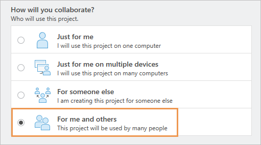

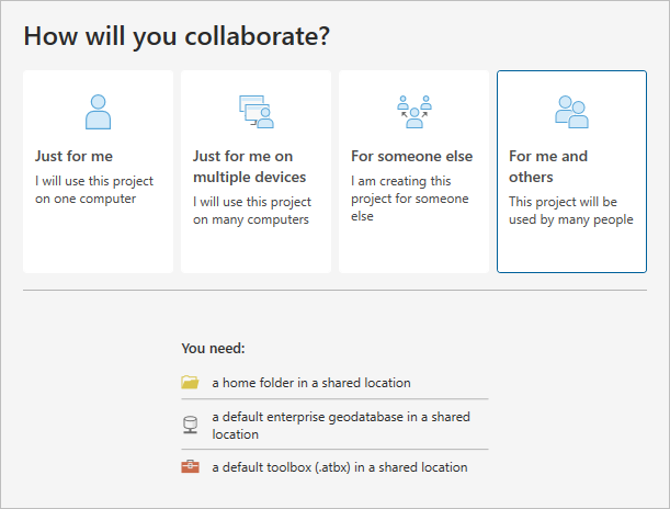

  7. Under How will you collaborate, click the For me and others collaboration type.

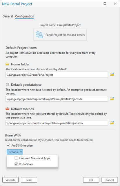

  8. Click the Configuration tab at the top of the dialog box.

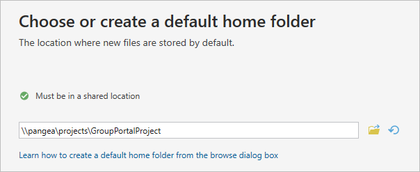

    The home folder, default geodatabase, and default toolbox paths are populated from the local project. In the image below, the default geodatabase setting is not valid because the existing portal project (PortalProject1) uses a file geodatabase, and the new portal project (PortalProject2) requires an enterprise geodatabase.
    New Portal Project dialog box displaying an error for the default geodatabase setting
    Tip:
    The Reset button at the bottom of the dialog box replaces the current settings with the settings in the general application options if they exist.

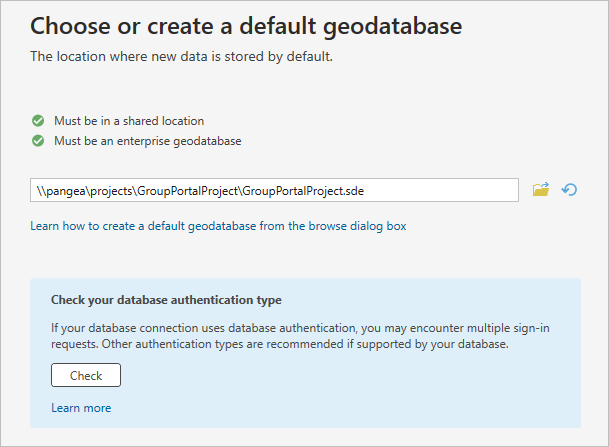

  9. Change the default project item settings as needed to resolve errors.
    Default geodatabase setting showing an enterprise geodatabase
    Note:
    Default settings may be valid without being desirable. In the image above, the new portal project (PortalProject2) has the same home folder and default toolbox as the existing portal project (PortalProject1). If both projects are in use, there may be confusion about which project certain items are associated with.

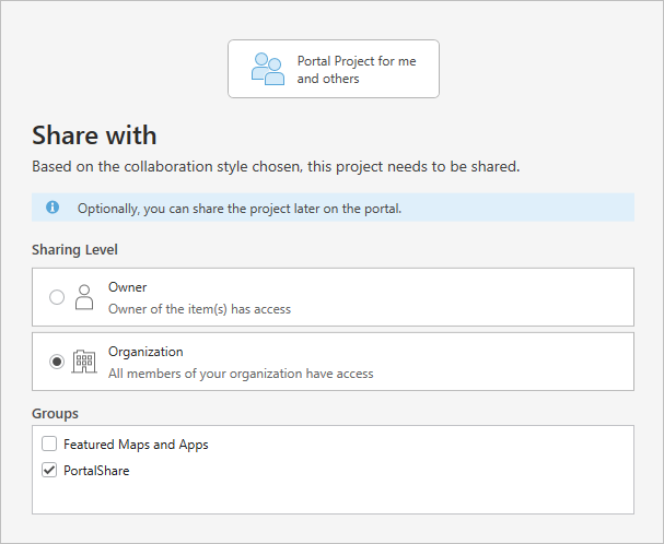

  10. In the Share With section, click the Groups drop-down arrow and check a shared update group check box.
    Note:
