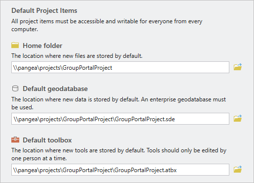

Default project items
A portal project, like a local project, must have a home folder, default geodatabase, and default toolbox. In a portal project, the home folder does not store the project (the .aprx file) but does store other files typically stored in a project home folder such as map and layer files, exported datasets, and connection files.
In a portal project, default project items are not created automatically when the project is created. You can either specify these default items each time you create a portal project or make default item settings in the general options for creating projects on an ArcGIS Enterprise portal. Default settings for project items are useful if most of your projects use the same collaboration type, and if your data management practices allow you to use the same items to store files, data, and tools related to different projects.
You can override default settings as needed when you configure a new project.
Default project items on the Configuration tab of the New Portal Project dialog box
In this example, the default project items are located on a network drive and the default geodatabase is an enterprise geodatabase.
