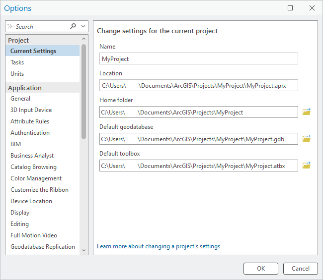

Change current settings for a project
On the Options dialog box, on the Current Settings tab, you can change the home folder, default geodatabase, and default toolbox for an open project.
The current settings for a project on the Options dialog box

Access the current settings for a project
Complete the following steps to access the project's current settings:
  1. In an open project, on the ribbon, click the Project tab to open the ArcGIS Pro settings.
  2. In the list of side tabs, click Options.
  3. On the Options dialog box, under Project, click Current Settings.

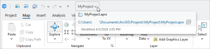

View the project name and location
The name and location of an open project can be viewed on the Options dialog box or on the application title bar.
Project name and location on the title bar of an open project
