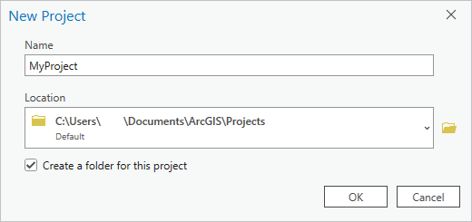

    The New Project dialog box appears with a default name and location. The default location is the \Documents\ArcGIS\Projects folder in your user profile.
  3. Optionally, type a different name in the Name box.
    The name you choose is applied to the project file and can't be changed after the project is created. If the project is created with default settings, the name is also applied to the default geodatabase, default toolbox, and home folder.
  4. Optionally, click Browse and browse to a location, or click the Location drop-down arrow and choose a recent location.
  5. Optionally, uncheck the Create a folder for this project check box if you don't want to store the project file in its own folder.
    Default settings are shown on the New Project dialog box.
