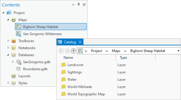

When a catalog view is active, the Contents pane lists the items in the project. As in File Explorer, items in the Contents pane are displayed to the container level. For example, folders, file geodatabases, toolboxes, and maps are displayed because they are item containers. The contents of a selected container, such as feature classes in a geodatabase, are correspondingly displayed in the catalog view.
Catalog view and associated Contents pane
When a map is selected in the Contents pane, its layers display in the catalog view.

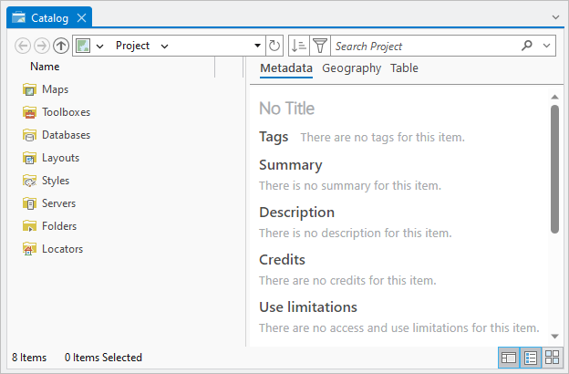

Open a catalog view
You can open two or more catalog views and use them to compare the contents of databases or folders, compare metadata for two items, copy items from one style to another, and so on. New catalog views open to the top level of the catalog: the Project container . When you browse to a location in a catalog view, save the project, and later reopen it, the view starts by default from its saved location. You can change the default behavior in the catalog browsing options.
When you create a project from the Catalog project template , the project starts with an open catalog view. In other projects, follow these steps to open a catalog view:
  1. Click the View tab on the ribbon.
  2. In the Windows group, click Catalog View .
    A catalog view opens. Any catalog views that are already open remain open.
    Catalog view
    The list of item containers, such as Maps, Toolboxes, and so on, varies according to the types of items that have been added to the project.

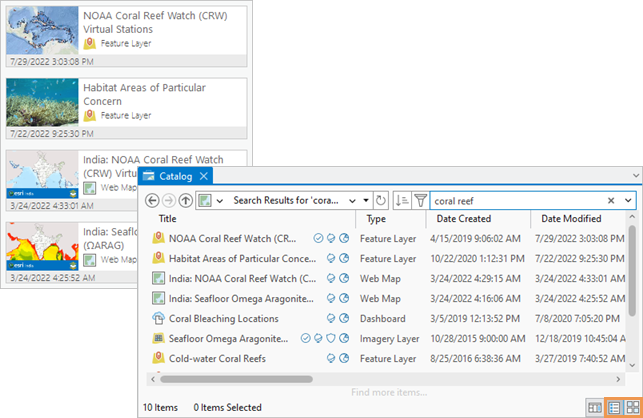

Display items in columns or as tiles
You can display items in a catalog view in columns or as tiles. In the column display, items and their properties appear in columns that can be sorted. In the tile display, items appear as tiles that show a thumbnail image (if one exists) and other properties.
Catalog view of ArcGIS Living Atlas of the World items displayed as tiles and in columns
Portal items are displayed as tiles and in columns. You can switch the display mode on the ribbon or with buttons in the view.

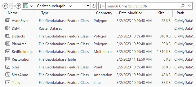

  • Most items with file extensions show their name, type, modification date, size, and path. For items such as enterprise geodatabases, servers, and cloud stores, the size is the size of the connection file.
  • Feature classes in file, mobile, and enterprise geodatabases, as well as stand-alone feature classes such as shapefiles and CAD files, show their geometry type.
  • Feature classes in file geodatabases show their modification date and size if set to do so in the catalog browsing options. Other file geodatabase items, such as raster datasets, display only their name, type, and path.
File geodatabase item properties, including feature class size, in a catalog view

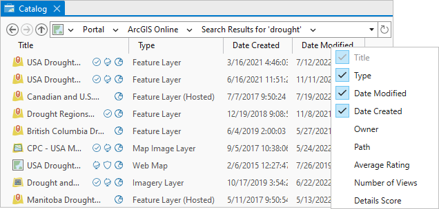

Turn columns on or off
Follow these steps to turn columns on or off in a catalog view:
  1. Make a catalog view active. If necessary, display items in columns.
  2. Right-click any column header to display a drop-down list of the columns.
    Visible columns have a check mark. Columns that aren't visible have no check mark.
    Catalog view and drop-down list of columns
  3. In the drop-down list, click the name of any column to turn it on or off.

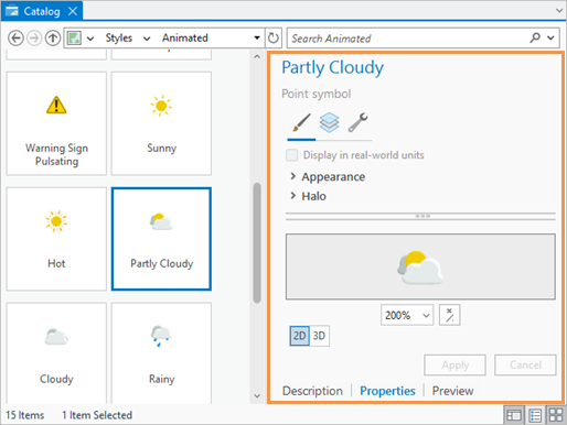

Work with item details
The details panel of a catalog view allows you to work with item properties in various ways. You can view metadata, preview data, create thumbnail images, manage styles, and update data sources for map layers. The details panel is shown by default but can be hidden. You can drag the details panel by its border to resize it.
Catalog view showing the details panel
A style item is selected in a catalog view. The details panel, outlined in orange, shows the item properties.

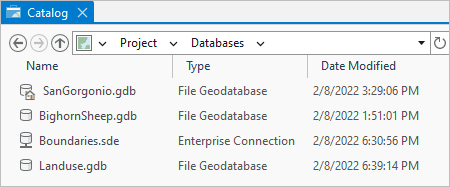

The contents of a project item container are displayed in alphabetical order after the default item (if there is one). For example, the maps in the Maps container appear in alphabetical order. Similarly, the databases in the Databases container appear in alphabetical order after the default geodatabase. In the Styles container , system styles appear in alphabetical order after the Favorites style .
List of databases in a catalog view

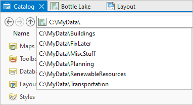

Use the location bar
The location bar at the top of a catalog view shows the current location in the catalog.
Location bar
You can use the location bar to browse items in the following ways:
  • Click a location in the current path to browse to it.
  • Click the location bar drop-down arrow to see a list of previously visited locations. Click a list item to browse to that location.
  • Paste or type a path in the bar to browse to that location. If the location is a folder, a folder connection is added to the project if your catalog browsing options are set accordingly.
  • Click the map button in the location bar to format the location as a path that can be copied to the clipboard.
  • Click Up to go up a level in the current location's path.
  • Click Back and Forward to revisit locations.
  • Type a partial path followed by a backslash separator (\) to see a drop-down list of available matching paths. Click a path in the list to browse to it. You can also type Windows environment variables, such as %AppData%</mark> or %Tmp%</mark>.
    Location bar showing a partial path with a drop-down list of autocomplete options
