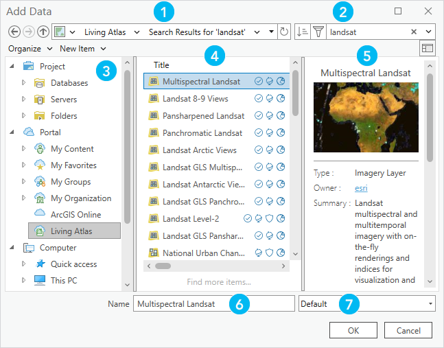

The browse dialog box elements are described in the following table. The numbers in the table correspond to the numbers in the image above.
Element
Description
1 Location bar
The location bar shows the current catalog location. As in a catalog view, you can type or paste paths into it. Type a partial path followed by a backslash separator (\) to see a drop-down list of available matching paths.
2 Search box
You can search project items or search portal items.
3 Navigation pane
Double-click a project or portal item container to browse its contents. Only containers relevant to the current operation are displayed. You can also browse to items on your computer or mapped network drives.
4 Contents list
View the contents of the current location or the current search results.
5 Details panel
View item information for a selected item. This is the same information available in a detailed item pop-up in the Catalog pane.
6 Name text box
If an item is selected in the contents list, its name appears in the box. If no item is selected, you can type in the box. A list of matching items in the current location appears as you type. You can also change locations by typing or pasting a path. Type a partial path followed by a backslash separator (\) to see a drop-down list of available matching paths.
7 Item type filter
Click the drop-down arrow and choose an option to filter the contents list by item type.

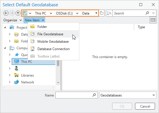

  2. Click the New Item drop-down arrow and click the type of item you want to create.
    Browse dialog box showing New Item drop-down menu
    In this example, a file geodatabase will be created in the C:\Data folder.
    The item is created with a default name, such as New File Geodatabase. The name is selected and editable.
    Note:
    In this example, you can create a file geodatabase, a mobile geodatabase, or a connection to an enterprise geodatabase. Any of these items can be the default geodatabase. You can also create a folder in order to create a geodatabase within that folder. However, you cannot create a toolbox because a toolbox is not a geodatabase or a geodatabase container.

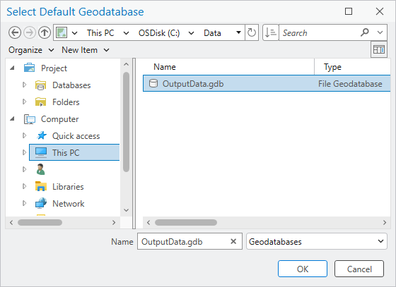

  3. Type a name for the item, press the Enter key, and click the item to select it.
    Browse dialog box showing renamed file geodatabase
    The new geodatabase is named OutputData.gdb.

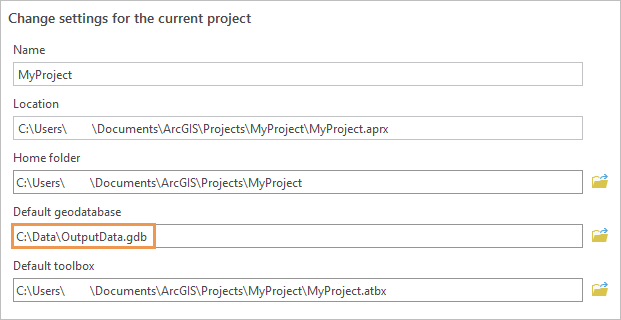

  5. Confirm that the new item is specified as intended.
    Options dialog box showing current project settings
    The new file geodatabase is set as the default geodatabase for the current project.
