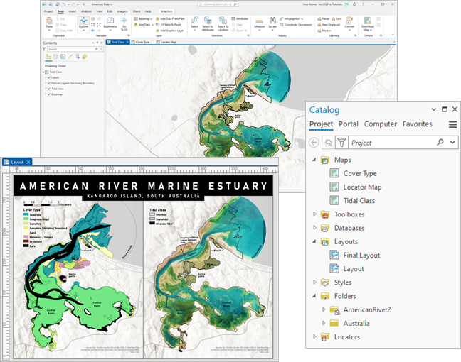

A project showing a map, a layout, and the Catalog pane

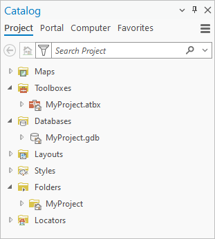

Project items and connections are managed through the project catalog, which can be accessed through the Catalog pane or a catalog view.
Project connections in the Catalog pane
Connections to a default toolbox (with the file extension .atbx), default geodatabase (with the file extension .gdb), and home folder are made automatically.

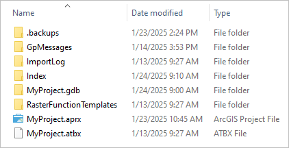

For each project, ArcGIS Pro creates a number of additional files and folders in the home folder. These include the project index and project backup.
Content of a project home folder in File Explorer
A File Explorer view of a project file (MyProject.aprx) and associated files and folders.

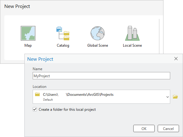

You can create projects on the ArcGIS Pro start page by choosing one of the default project templates: Map, Catalog, Global Scene or Local Scene. Each template defines a different initial state of the new project. For example, a project created from the Map template starts with an open map.
Choosing a template opens the New Project dialog box, where you name the project and choose where to save it.
Learn more about starting your work
Default project templates and New Project dialog box

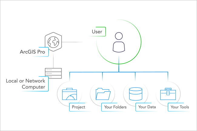

The data and other external resources you connect to may be stored on your computer, network drives, GIS servers, portals, or other remote locations. Performance is best when a project and its data are stored locally.
Learn more about project and data location
Diagram of a user and the location of a project and its resources

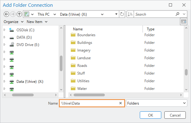

If a project is located on a network drive, the best practice is to add item connections as UNC paths. This avoids access problems that occur when a drive is mapped with different letters on different users' computers. To add a connection as a UNC path, you must type the path in the browse dialog box that establishes the connection. If you browse to and select the location, the connection automatically references a drive letter.
Add Folder Connection dialog box with a UNC path specified
Add connections to network drives with UNC paths.

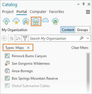

Maps, scenes, layers, and tables can be created in ArcGIS Pro or ArcGIS Online and saved as web items. Web items can be added to ArcGIS Pro projects and used in other ArcGIS applications. Web items are added to a project directly from your active portal—unlike packages stored on a portal, which are first downloaded to your computer.
Web items can be updated or replaced by the item owner. If the item owner enables editing, users of web layers and tables can edit these items. If editing is not enabled, users can still modify item properties in their own project without changing the item on the portal.
Catalog pane showing a list of web maps
Items you can add to a project from your active portal include web maps, map packages, and map files.
