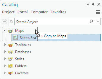

Drag items stored in the project file to copy them
To copy an item stored in the project file (.aprx), such as a map or layout, browse to the item and select it in the Catalog pane, a catalog view, or the Contents pane of a catalog view. Press Ctrl and drag the item to the appropriate container. Dragging without using the Ctrl key doesn't work in this context.
A map copied to the Maps container in the Catalog pane
The Salton Sea map is copied in the project using Ctrl and drag.

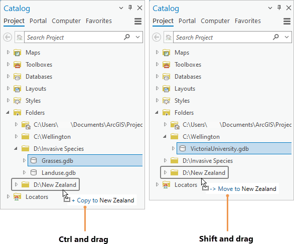

Drag items stored on the file system to copy or move them
To copy or move a file system item stored outside the project file, browse to the item and select it in the Catalog pane, a catalog view, or the Contents pane of a catalog view. Drag the item to the destination folder. (As you drag, a ScreenTip confirms whether the item will be copied or moved.) Press Ctrl and drag to enforce a copy. Press Shift and drag to enforce a move.
Side-by-side examples of a geodatabase being copied and moved by dragging with modifier keys
In the first image, Ctrl and drag is used to copy a geodatabase that simple dragging would move. In the second image, Shift and drag is used to move a geodatabase that simple dragging would copy.
You can drag file system items without using the Ctrl or Shift key as described in the following table:
